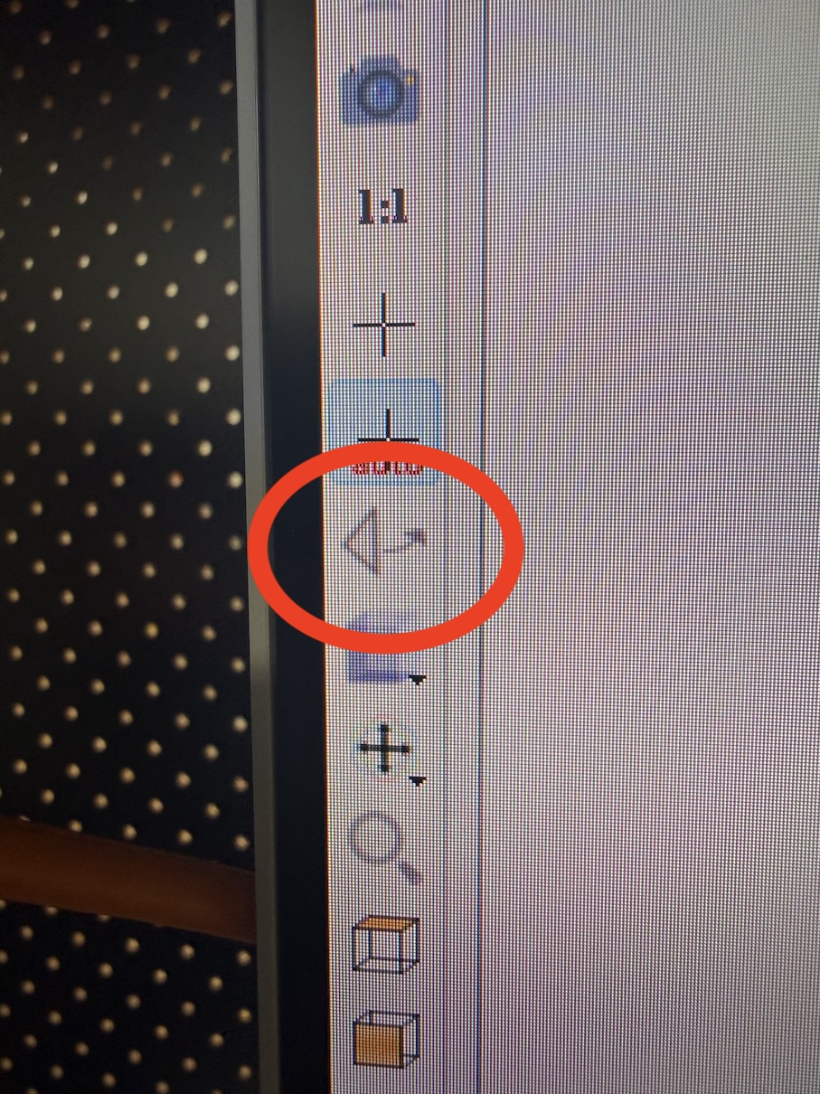

I recently discovered CC and its been incredibly useful for quickly aligning a face of a 3D scan mesh to the XY plane. Much quicker than the einscan software the scanner bundles with.
However, the feature I use seems to only show up on the windows version of the app. My daily drive is a macbook pro.
Is there a way of retrieving this function on the mac version? Or am I just not seeing it in the interface?
Here is the picture of the icon in the windows version.
Thanks!
3 point fit icon
3 point fit icon
3 point icon.jpg (518.36 KiB) Viewed 8280 times
Re: Is 3 point align feature missing on Mac version?
(Well, I don't see any reason why it wouldn't be accessible in the macOS version... Are you selecting a point cloud or a mesh entity to make it enabled? (selecting the top group/folder won't work).
If it doesn't activate after you select a point cloud or a mesh, and it's a relatively recent version of CloudCompare, then you may want to open a bug 'issue' on github: https://github.com/CloudCompare/CloudCompare/issues (this way the macOS maintainers will see it).

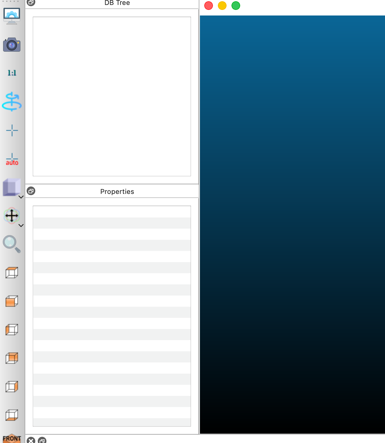

To clarify, the screenshot I attached is the PC version which does have the feature (The button does become active when I select a mesh.)
The Mac version (pictured here) does not have that button/icon at all.
Is that a bug or deliberately missing from the mac release?
Screenshot 2026-07-12 at 7.42.03 pm.png (114.16 KiB) Viewed 7524 times
Is it a very old version of CC? Which version are you using on macOS?

I downloaded it on 30th June in what I thought was the latest version - 2.14.0
Is there newer versions for Mac?
elsy
Joined: Wed Jul 08, 2026 4:47 am
Post by elsy »
I downgraded to "CloudCompare_2.13.2_arm64" version and now its there
So perhaps an issue isolated to 2.14 beta?
Sorry, it seems a 2.14 version 'issue' indeed. But it's just the icon that has disappeared. You normally still have access to this tool via 'Tools > Levels'
