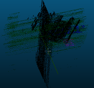

I used laspy to add a new dimension to the original las file. The new file works OK in QTreader and FurgroViewer but corrupt in cloudcompare.
new file
new file
original file
original file

I confirm that the issue was fixed when upgrading LibLAS to version 1.8.
