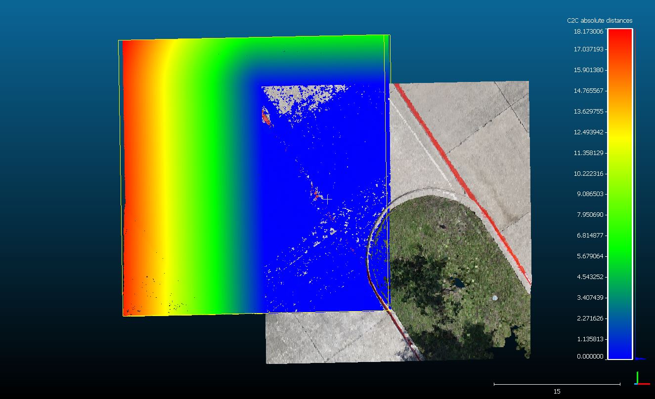

Hello everyone. I am a new user of cloud compare and I am trying to compare cloud to cloud distances. I have two point clouds overlapped on each other with a certain common area. The values are as shown in the figure and I would like to know the value of c2c distances instead of a bar. Can you please let me know how I can do that ? Thanks!
- compare.JPG (135.75 KiB) Viewed 8783 times
Re: C2C non-absolute distances
If you want to see particular distance values associated to particular points, you can use the 'shift + left click' shortcut to spawn a label on a point (or use the 'Point picking' tool: http://www.cloudcompare.org/doc/wiki/in ... nt_Picking).
You can change the colors/parameters of the currently displayed scalar field (see http://www.cloudcompare.org/doc/wiki/in ... properties and http://www.cloudcompare.org/doc/wiki/in ... es_Manager) to get a better visualization of what's happening in the part of interest. You can also extract the points below a given distance (or equivalently set a maximum distance when you compute the distances).
Otherwise you can also export all the values (with the points) if you export save the cloud as an ASCII file.
