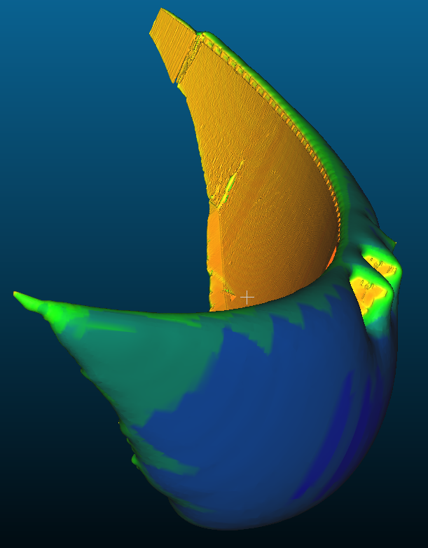

I wanted to apply the PoissonRecon tool on a pointcloud representing a dam. Therefor I computed the normals with these parameters:
- quadric model (good for curvy surfaces like the dam)
- Radius = 0.051 instead of 0.041 (0.041 was the auto-computed radius) I understood a bigger radius was good to get better normals
- minimum spanning tree with knn = 6
Computation took a lot of time because of my computer but the normals were good (white and not black).
Then I used the PoissonRecon tool with octree depth = 11 and with the output density as SF (SF = scalar fields, right?)

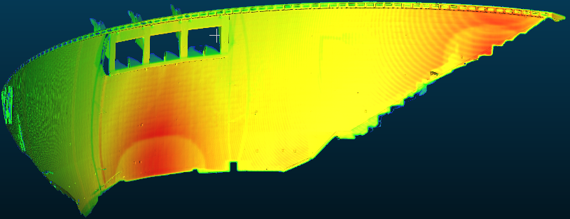

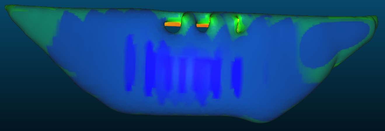

The 3 attached pictures show the result. The front side of the dam is really nice I guess (red/orange part) except for the left side but I know it's because of the noise. And the back side of the dam is really strange. I only scanned the front side.
Could you explain me why the reconstruction is really weird?

Poisson always create a closed mesh by default. You then have to reduce its coverage.
See the documentation about PoissonRecon: http://www.cloudcompare.org/doc/wiki/in ... n_(plugin) (especially the section about Using the output density).
