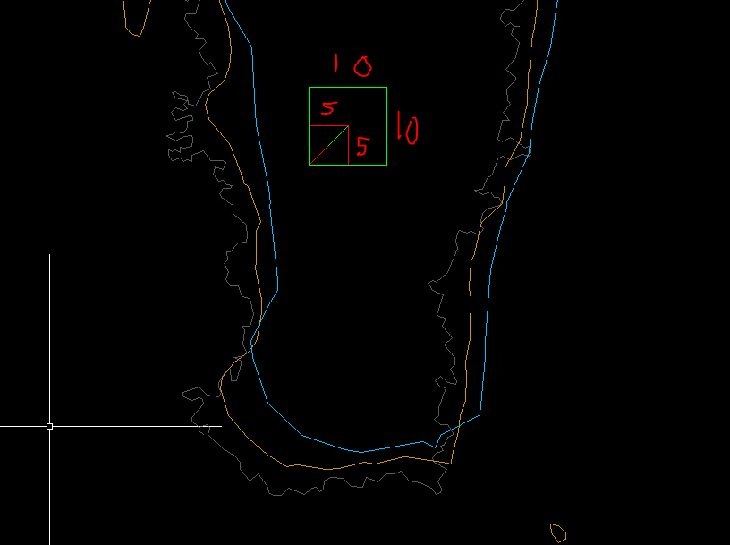

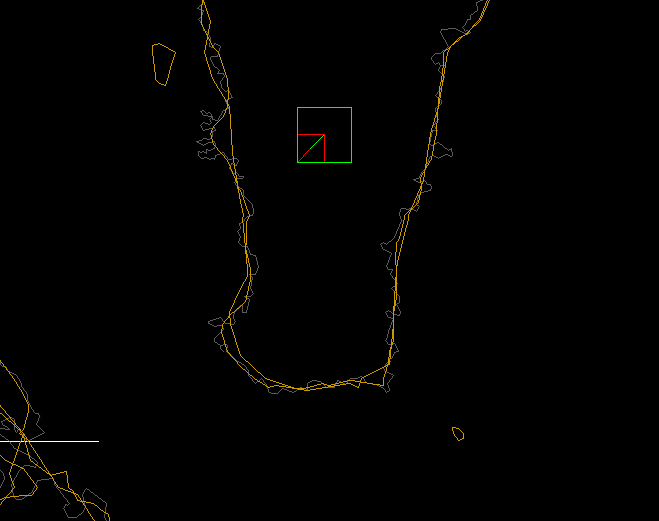

Hello guys,
I just came across this issue as well and I think I have figured it out. When cloud compare creates a raster grid it doesn't put the new point in the right X,Y co-ordinate. As such if you make a 10 m average grid then you will see a shift in your contours by 7.0711 m to the north-east.
The easiest fix for this is to simply shift the points to the south-west by a value found using this formulae: shift distance = (Grid spacing * Sqrt(2))/2 or just subtract half of the grid spacing from your x and y values.
Daniel would it be possible to have this shift added into Cloud Compare?
Here are a couple pictures of the surface i'm working with. Grey is as provided by a surveyor, orange is a 5 m average raster and the blue is a 10 m average raster. Red square is 5 x 5 square, green is 10 by 10 square.
Unadjusted:
unadjusted surfaces.PNG (29.6 KiB) Viewed 16411 times
Shifted:
adjusted surfaces.PNG (10.6 KiB) Viewed 16411 times
kind regards,
Andrew
