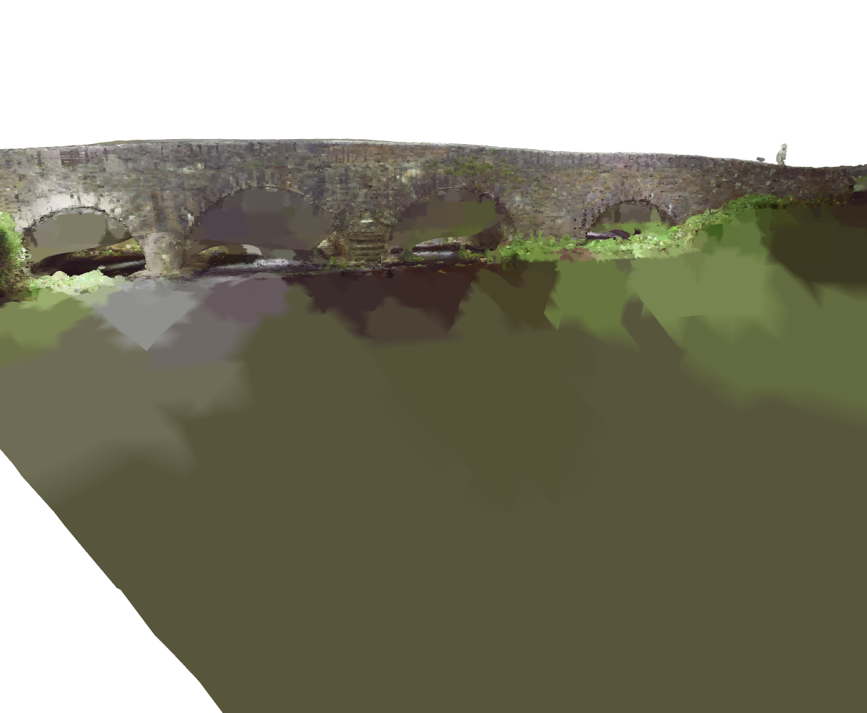

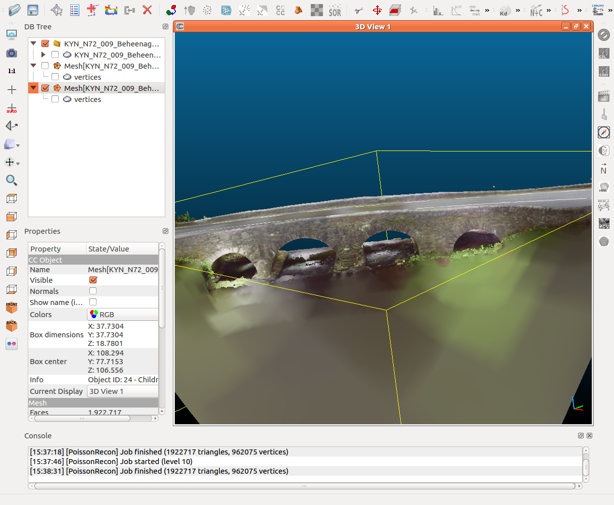

I have been trying to compare the result of Poisson Reconstruction algorithm in cloudcompare and open3d. Im attaching the images. is there any way to improve the result in open3d?
- cloudcompare_mesh.png (466.55 KiB) Viewed 18584 times
- mesh_open3d.png (416.87 KiB) Viewed 18584 times

Yes you have to generate the "density" scalar field and then remove the triangles corresponding to low density areas.
See https://www.cloudcompare.org/doc/wiki/i ... n_(plugin) (last section, about "Using the output density").

thanks daniel for reply. I can successfully improve the result in cloudcompare. now the thing is If you have a closer look on both the images that I attached the mesh through cloudcompare is very sharp but the one through open3d library of python is not very good. The algorithm to generate the mesh in both the cases is same "Poisson reconstruction". Do you have any idea how can I achieve the same result in open3d?

One thing that might be misleading here is also the way colors are interpolated inside the triangles? They look a little bit funky in the open3D capture... What I mean is that maybe the mesh structure is the same, but the colors are either not interpolated correctly, or not displayed properly?
Re: Mesh in Cloud compare and python script
you might be right about the color interpolation.
But what I found out is in open3d the normal computation does not follow the orientation of normal. so by setting everything the same I computed the normal (unchecking the orientation through the spanning it) in CC and was able to replicate the result like open3D.
