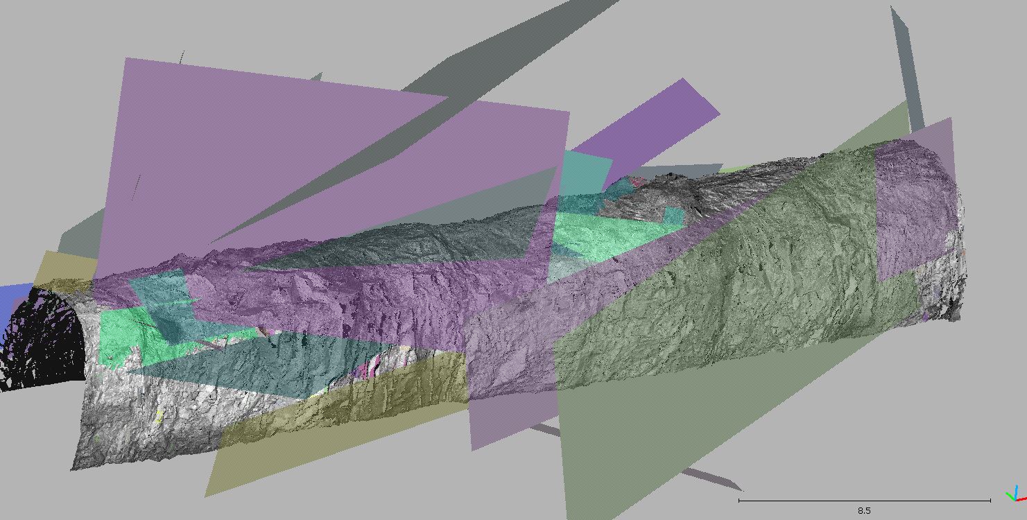

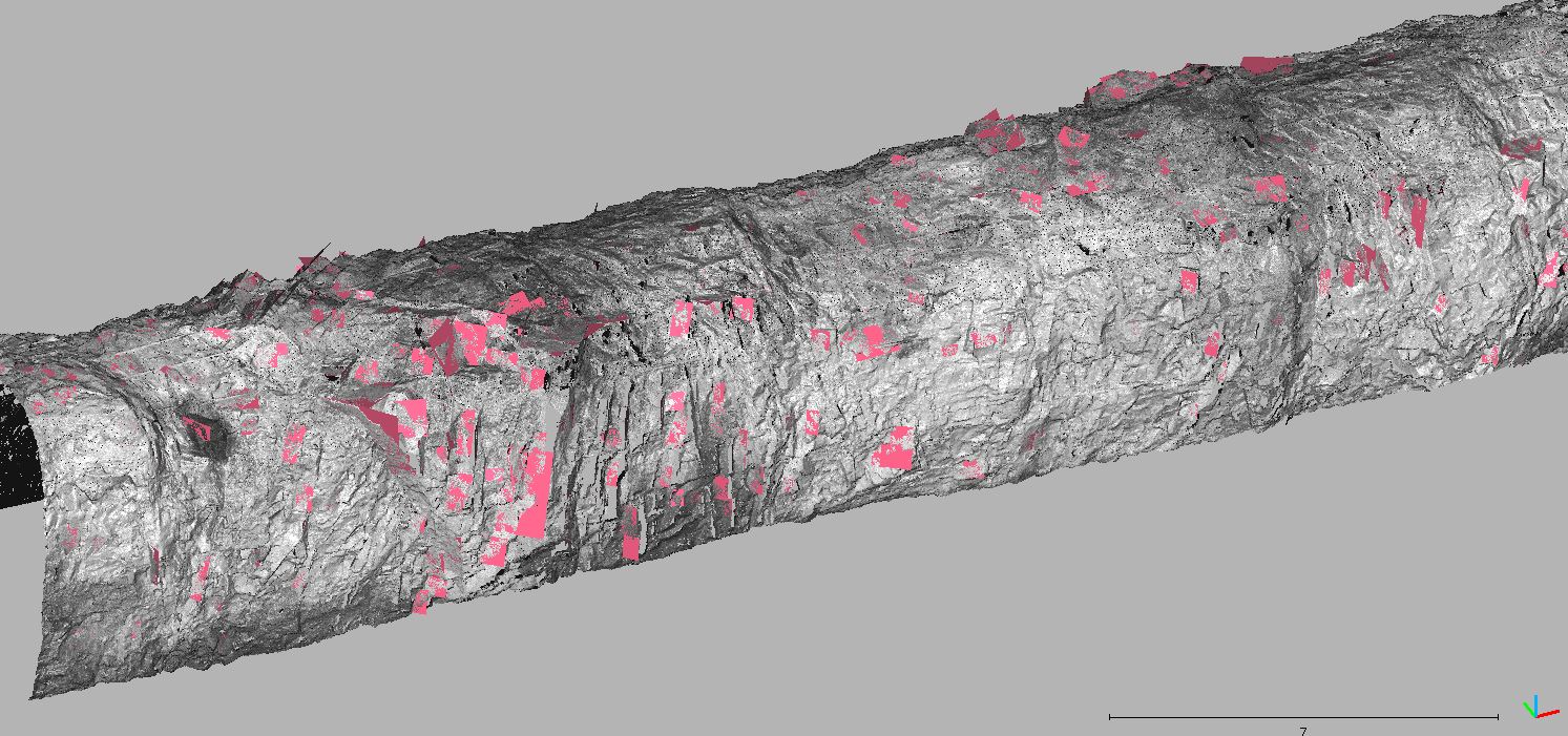

I tried to remove the global shift scale by setting X and Y to 0, but that did not help. I'm running CloudCompare 2.11.beta - 26/03/2020, but I noticed this issue already in the 03/03/2020 downloaded version. My computer has the following specs:
- Windows 10 Pro for workstations ver. 1803
- Graphic cads: Intel UHD Graphics P630
NVIDIA Quadro P4200
The cloud that I have tested on is a scanned rock tunnel, containing 2.45 milj points with a subsampled spacing of 0.01 m. The RANSCAC parameters are the following:
Primitives=Planes
Min support points = 100
e = 0.02
b = 0.01
a = 5°
overlooking probability = 0.000001
Attached is also two images, that show how the planes were generated with the "old" RANSAC code vs. "new" code. Approximately same RANSAC parameters have been used for both runs.
Best regards,
Gustav
NVIDIA Quadro P4200
Primitives=Planes
e = 0.02
b = 0.01
a = 5°
Best regards,
Gustav
- RANSAC_old-version.JPG (244.64 KiB) Viewed 17716 times
- RANSAC_new-version.JPG (261.95 KiB) Viewed 17716 times
