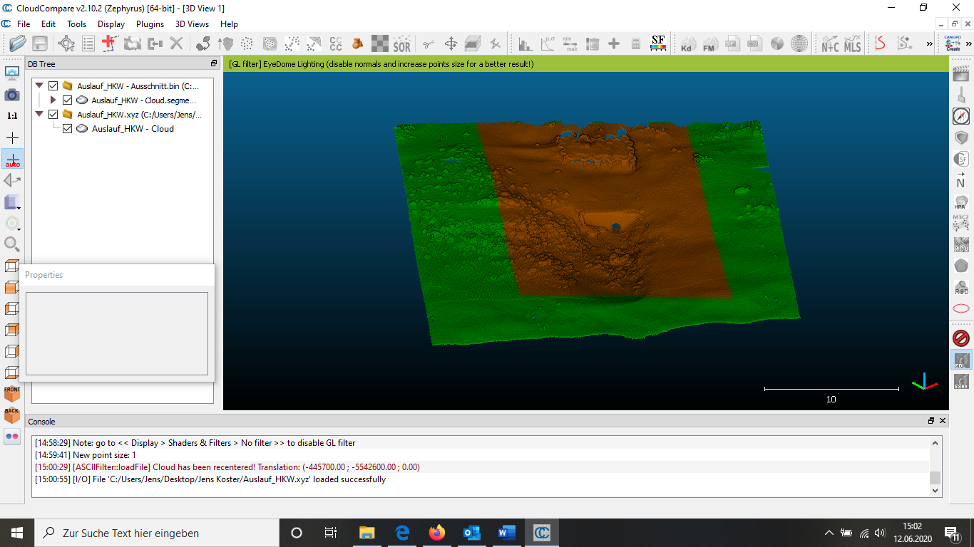

i have a underwater sonar scan of a tube ending in the river.
I am trying to convert this xyz sonar scan pointcloud into a stl model for 3D printing.
Cloudcompare breaks down if i try to compute normals at the point of 96%.
I thinks ist not a Problem with the size of the Cloud, i cut a segment out to the halve size, same Problem.
What is my mistake there?
Thank you!

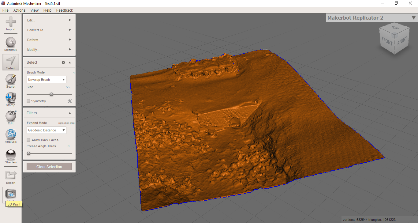

yes thanks that was the solution.
Now it works.
I created my first 3D mesh with the recon Plugin.
It is a bit raw, but i will Play a bit with the Settings.
Thanks!

- Meshmix.PNG (411.74 KiB) Viewed 11324 times

I see that you didn't remove the parts of the mesh with low density (the bubbles, etc.). Was it intentional?

How do i do this?
Is this the reason because the surface is so bad…
It Looks like the some points are swollen up.
In Pointcloud the Surface of the model was much more detailed…
Re: convert xyz sonar scan in stl
See https://www.cloudcompare.org/doc/wiki/i ... n_(plugin) (and especially the section titled "Using the output density").
The dialog tries to explain you that as well, but it's easy to miss that.
And the Poisson Reconstruction algorithm will always try to produce a closed surface, even with big holes, bad normals, etc. Therefore it can produce strange bubbly things to achieve that.

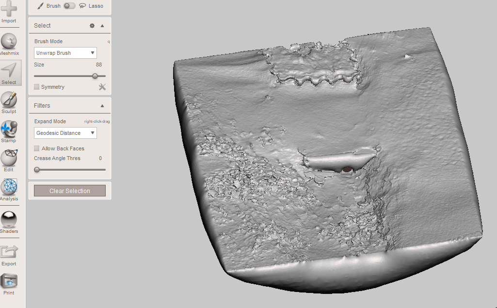

Thanks, i tryed it and now it Looks much better.
Enough for the first Prototyp print.
- Auslauf.png (515.67 KiB) Viewed 11250 times
