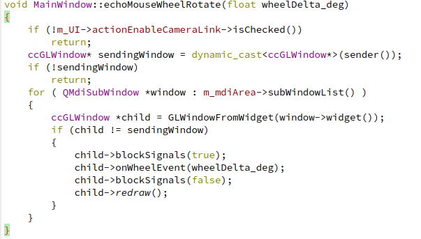

In the CloudCompare code, some functions simply "return" and do not execute subsequent code.
For example, a piece of code in this picture.
I wonder if the statement after this'return' will still be executed? Or under what conditions they'll execute!
When I block them, there is no effect on my compiled cloudcompare!
I'm guessing this might be a later change that you made to stop executing subsequent code.

No the code after a return statement will not execute if the return is.
This function is meant to echo or pass along a mouse wheel rotate event when there are more then one 3d windows and the camera link option is enabled.
Camera link will move all 3d windows at the same time while navigating.

You need two 3D views AND to enable the 'Display > Camera link' option.
