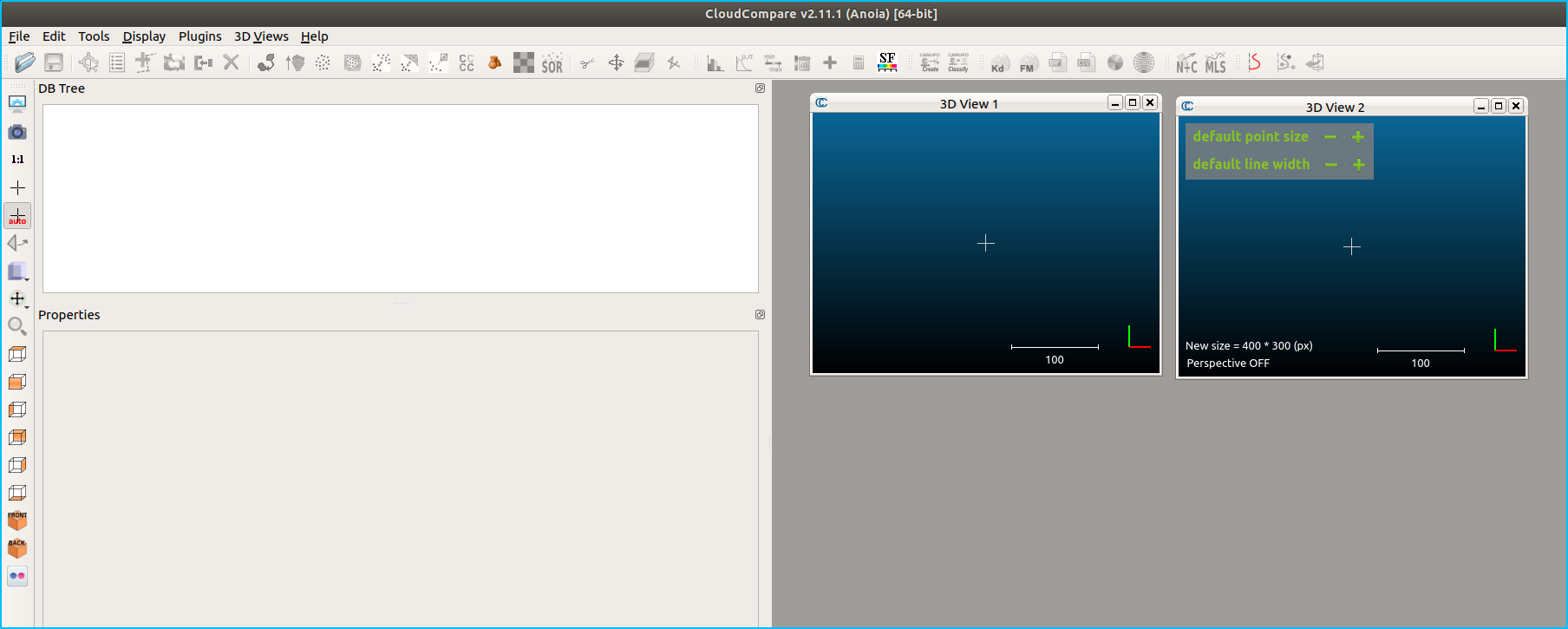

I want to create a new 3dviwer to put in the main cc interface. Like this
(I know cc comes with such a feature, but I want to implement it in my plugin so I can do it without changing anything inside cc.)
I have now implemented the following code to pop up a super large 3dviewer, but I can't link it with the cc main form.
