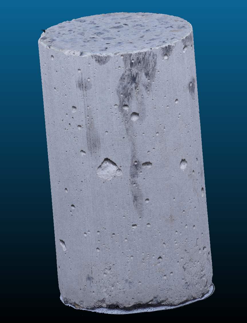

Hello. I am a relatively new user of CloudCompare. I am currently in the process of designing a workflow to quantify the corrosion of a concrete block using different point cloud capture methods (SfM photogrammetry and laser scanning). As part of this process, I would like to take point clouds of a cylindrical concrete block, similar to the image below and turn it into a flat surface. Is this possible within CloudCompare? I would appreciate any insight from the community. Thanks.

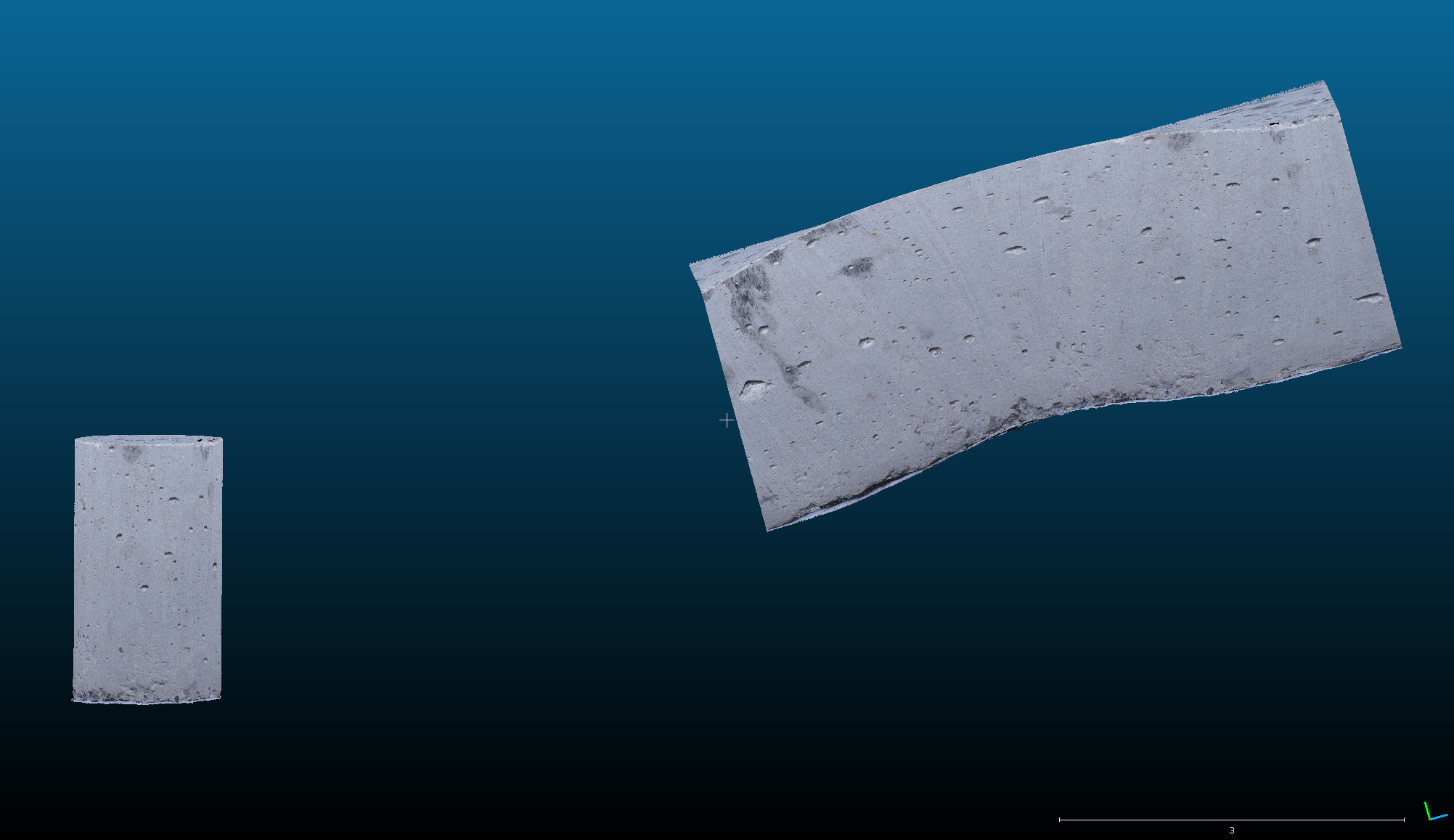

Hello again. I used the ‘unroll’ tool to unroll the cylinder shown in previous post about the Y-axis. The result is not the flat rectangular surface I was hoping for (pictured below). Is that because the concrete cylinder itself is not aligned to the Y-axis? If so, is there a way for me to align it? Apologies if this appears trivial, I am still new to CloudCompare. Thank you.

Yes you are supposed to align your cylinder/cloud indeed.
Either you do it manually (with the 'Edit > Transform/Rotate' tool), or you use the 'Level' tool to make the bottom or top surface horizontal for instance (if you trust them to be orthogonal to the cylinder axis)
