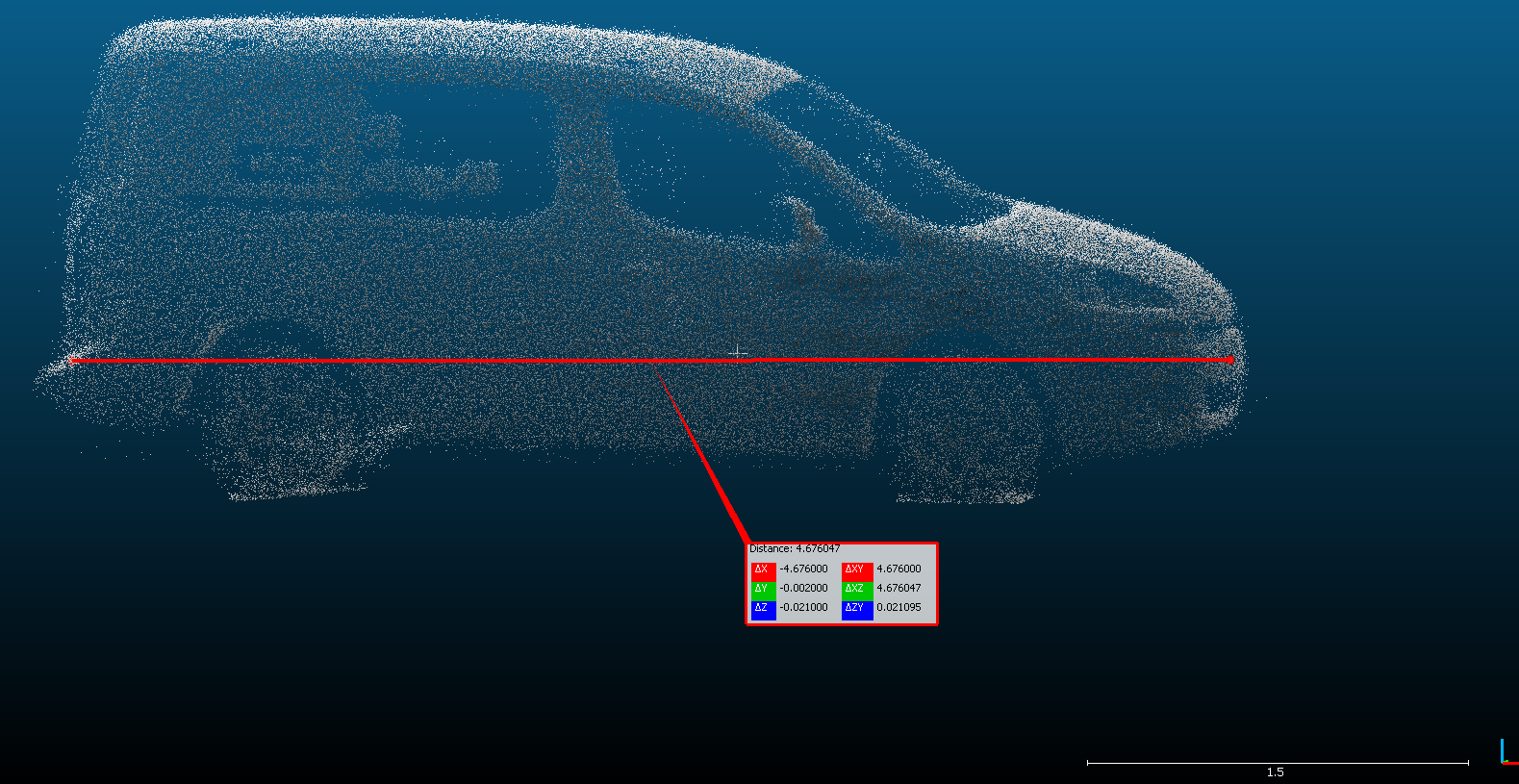

Post by ArveS »
Hei Daniel,
Just to clarify. In the picture i have attached i tried to evaluate the length of the car, and the distance is 4.67. Is this in meters or can i not be sure?

Re: Evaluate length and volume
You would have to check with the data provider / software that produced it.
But yes, 4.6m looks like a typical length for a car ;)
