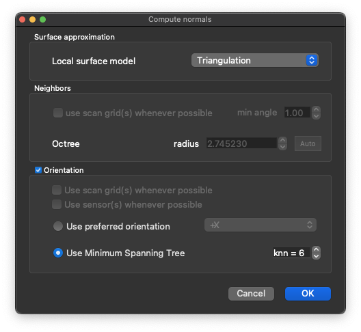

- compute normal (triangulation / orientation / use minimum... kn=6)
Screen Shot 2022-03-30 at 4.02.16 PM.png (83.39 KiB) Viewed 2221 times

Is it because it's the macOS version and it doesn't support triangulation? (because CGAL does not work well with this version).
Can you try another local model? I guess the Plane fit mode should be sufficient on such a large cloud.
