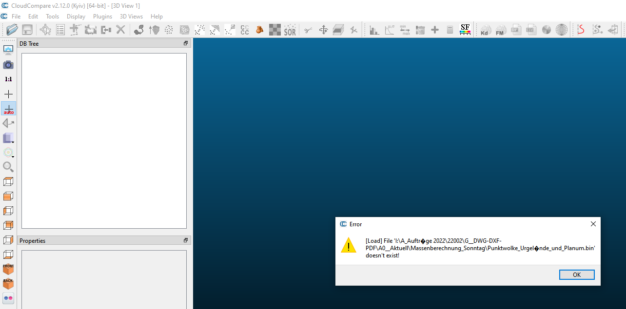

Cloudcompare seems to have problems opening projects if their path contains umlauts like "ä", "ö" or "ü" (German language).
See the attached picture
Screenshot
Screenshot
Best regards
Thomas

Ah, sadly I can't reproduce this issue on my side (and I already test Cyrillic, Japanese and French specific characters, so I added German ones ;).
Do you have the same issue with a very simple folder (such as "C:\Temp\äöü.bin")

But I have found the error in the meantime. Windows 11 does not seem to have UTF8 encoding enabled by default. But this can be activated manually and after that everything works fine.
However, that doesn't explain why the same problem occurs on my Windows 10 PC at work. After all, it worked with the alpha version of Cloudcomapre that I had previously installed. However, I will check on Monday at work to see if there is also a way to enable UTF8 encoding there (however, the PC is in a domain).
Here is a video that shows the problem and also the solution (for Windows 11):
