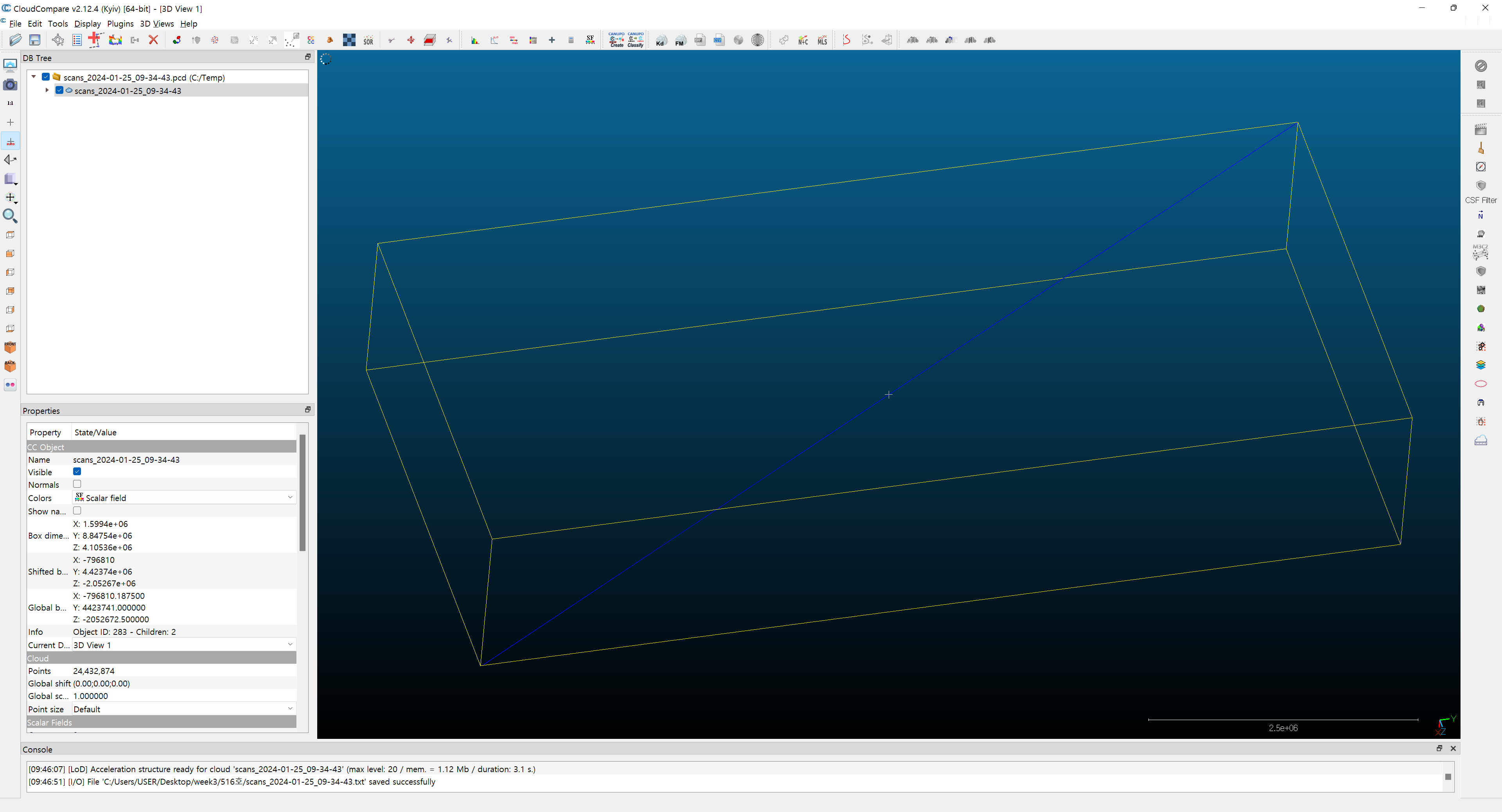

I am trying to create a pcd file with ouster lidar and display it, but only one solid line appears.
the screen that appears when opening the pcd file

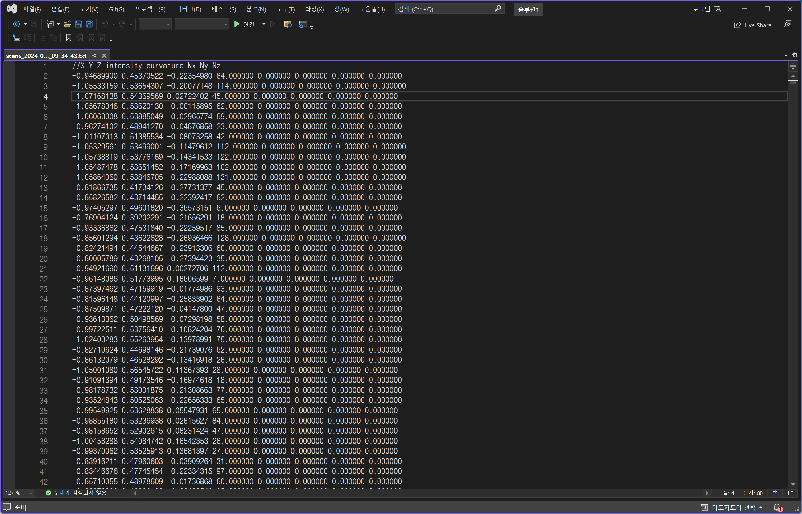

I wondered if I had made a mistake when acquiring the point cloud with LIDAR, so I changed the pcd file to a txt file and opened it, but it seemed to be acquired normally.
the screen that opens the txt file

I don't know for what reason. Would you give me a help?
I captured the screen that appears when opening the pcd file, and the screen that opens the txt file, and attached them as images.

Well, it seems that all the points are aligned.... Would you be able to share the file with me? ([email protected]). So that I can check whether the issue is with the file or with the PCL library (which is in charge of loading the PCD file).

So it turns out that most of the points are good (about 23.1 million of them), but the others (1.3 million) are very far and aligned. They cause the cloud to look like this very long line...
Not sure how it was generated?

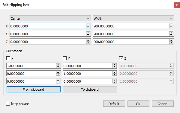

Anyway, one thing you can do is select the cloud, and use the 'Tools > Segmentation > Cross section' tool.
Then click on the 'advanced' button to define a clipping box to keep only the points with coordinates close to 0 (+/-100 m for instance):
Eventually click on the first red button below 'Slices' (Export selection as new entity). This will create a new cloud with only the points close to 0. You can get rid of the origin cloud and zoom on this new one (with the magnifier icon).
