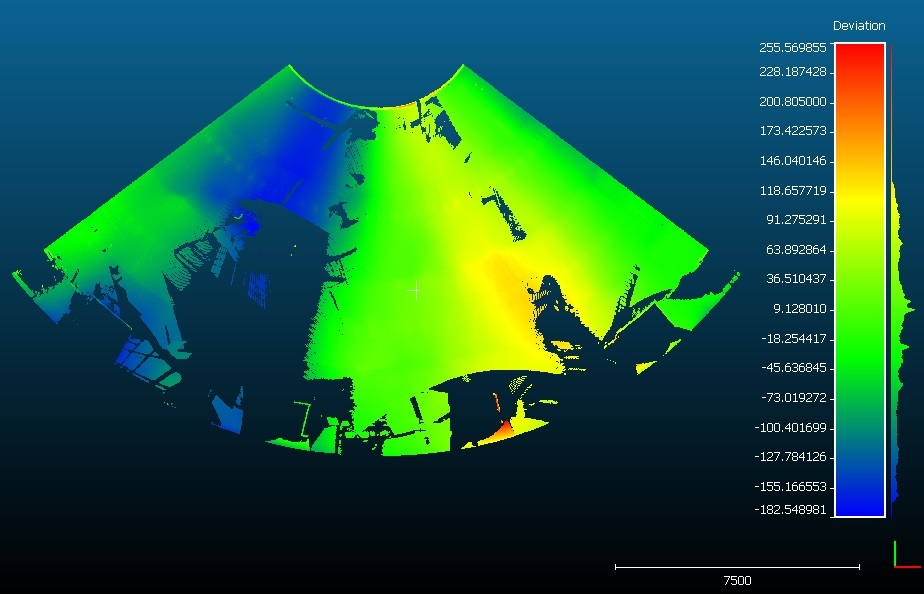

Cone
Since version 2.9, this method unrolls a cone in a way that preserves surfaces (as if the cone was 'rolling' on a planar surface). And since version 2.13, a sub-option 'Projection' allows to choose the type of conical projection among:
  • Conical
  • Cylindrical (fixed radius)
    • this mode corresponds to the old 'Cone' unrolling mode in version 2.8 and prior. It unrolls a cone-shaped cloud as if it was a cylinder, by first 'straightening' the cone walls.
  • Cylindrical (adaptive radius)
'Unroll cone' dialog

Export deviation scalar field
A checkbox named 'Export deviation scalar field' allows to compute for each point its radial distance to the theoretical unrolling shape (cylinder or cone). A new scalar field will be added to the output cloud.
