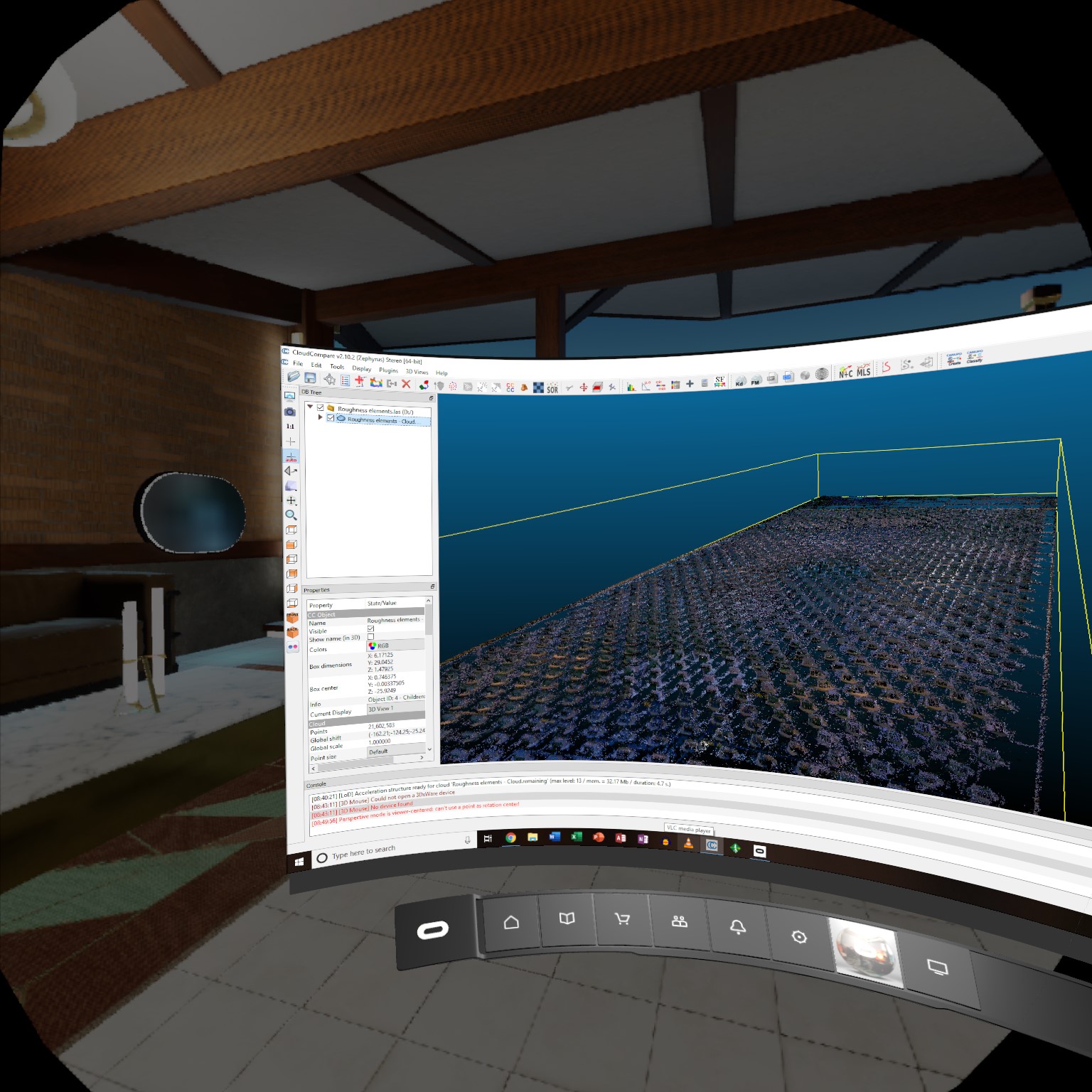

I am trying to use the Oculus Rift S with cloudcompare and having trouble viewing the pointcloud in the VR environment. I found this thread from 2016 with a similar issue but I'm not receiving the error they mention (http://cloudcompare.org/forum/viewtopic.php?t=1962). Same deal as in the post I linked, the Oculus software runs fine (Oculus App Version 1.38.0.250171), CloudCompare runs fine on its own (version 2.10.2 stereo). But I can't figure out how to initialize viewing the point cloud in 3D on the Oculus headset. All I can do is view the 2D desktop in the 3D Oculus environment (See attached screenshot). I'm running Windows 10 education version 1809 (OS Build 17763.529).
I don't care if the handsets work, I can use the mouse, I would just like to view the pointcloud in 3D on the headset. Does anyone know how to initialize this?
Thanks!

What error do you get (in CloudCompare's Console) when you try to activate the stereo mode? (the reg and blue glasses icon in the bottom left part)
