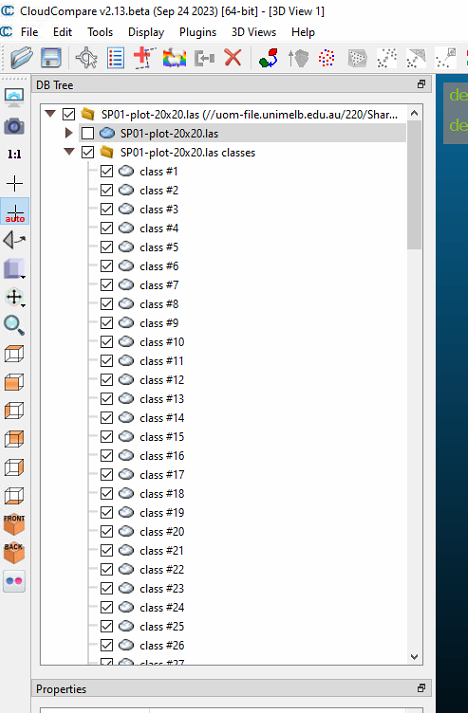

Hi all,
I was using the TreeIso plugin to separate trees, but wonder can I save all the .las file at once rather than save every single tree? Since I have too many of them.
Posts: 8178
Re: [Batch] Saving the .las file
Sadly no... Some formats allow to store multiple clouds at once (BIN, E57). Then you can batch the conversion of a BIN file to multiple LAS files via the command line:
'CloudCompare -O my_file.bin -C_EXPORT_FMT LAS -SAVE_CLOUDS'
We should had the option to save multiple files to other formats (currently only the TXT/ASCII format can do it I believe).

daniel wrote: Sat Mar 02, 2024 9:50 am Sadly no... Some formats allow to store multiple clouds at once (BIN, E57). Then you can batch the conversion of a BIN file to multiple LAS files via the command line:
Hi Daniel!
Is this possible now? If not, could you please explain how to do the batch conversion?
Thank you!
/Kaj
Posts: 8178
As far as I know, no one has done it (as this is an open source project, we can only rely on individual contributions).
