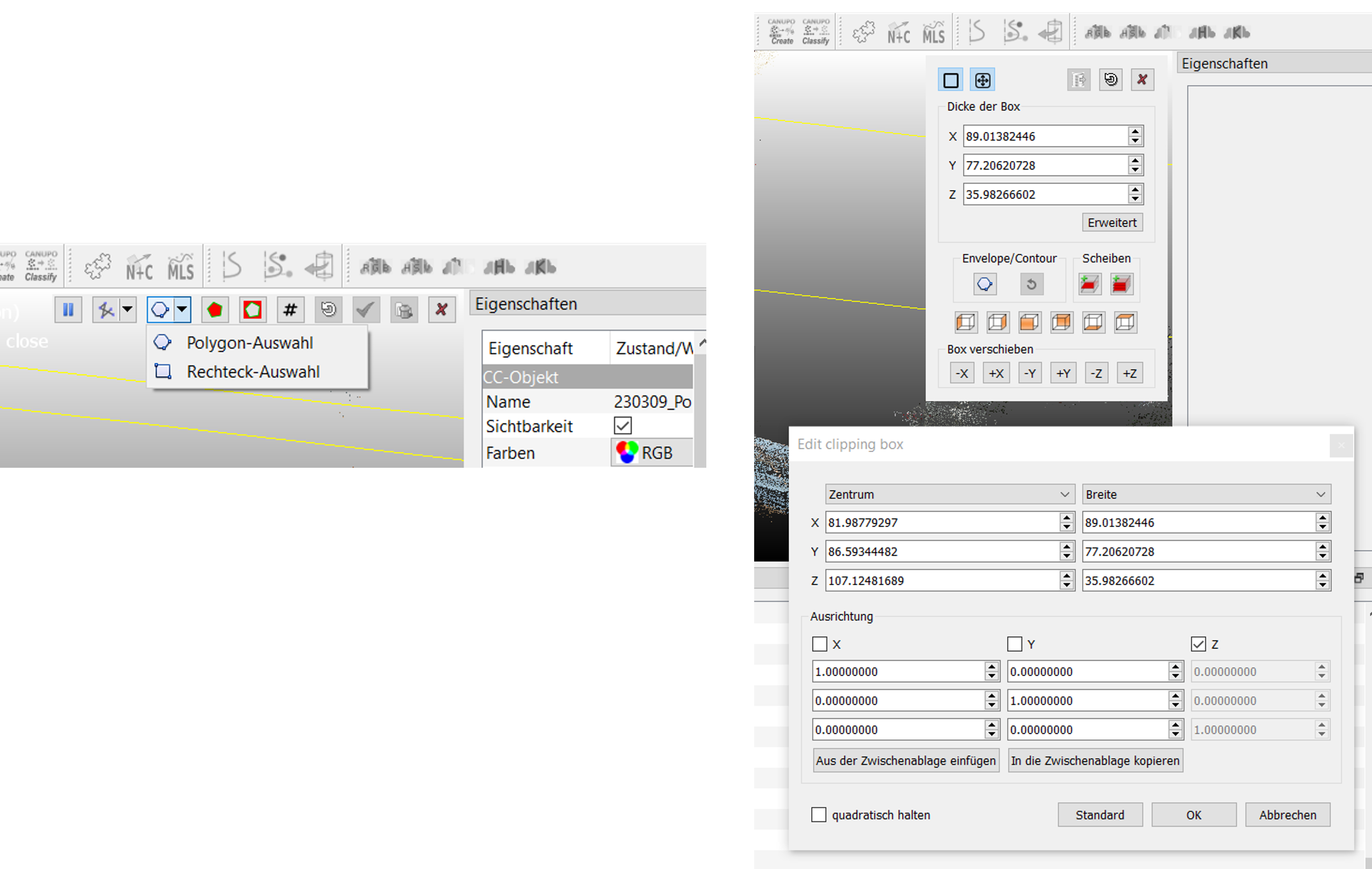

Hello Daniel,
is it or would it be possible to implement a combination of the two tools?
I want to clip a point cloud based on a given surface (list of coordinates or polygon). If no, do you have an idea, how it could do that manually?

Exactly, I want to cut out all points in a certain polygon considering a normal vector in the orthogonal direction (e.g. 10cm). That is, in a volume of interest = polygon * normal vector.
So yes.

Would it be possible to import a polyline into CloudCompare GUI? Then I also could use the scissors tool. I'd only need to define the orthogonal direction.
Re: Clipping with polygon list
So, no, you can't define the depth with CROP2D, it's an 'infinite' crop.
And yes, you can easily import a polyline as .poly file (it's a text file, with the X Y Z coordinates of each vertex per line).
