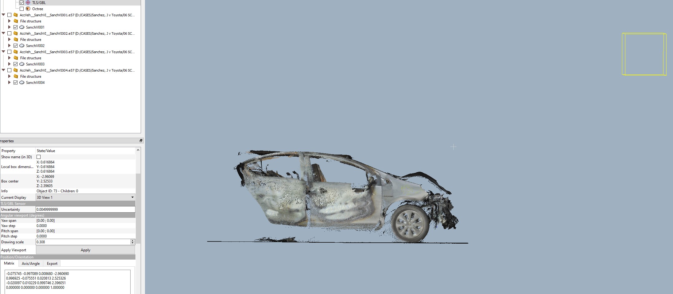

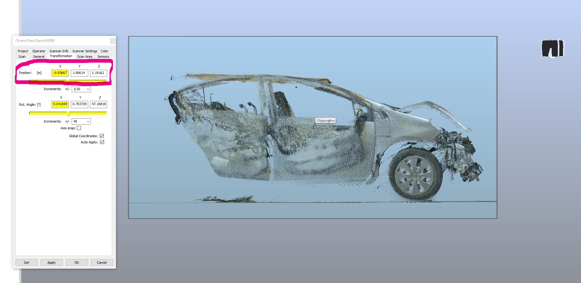

Looks like the 'sensor' position CC is generating isn't getting put in quite the right spot.
The scanner head data listed in the e57 exported from FARO scene:
<translation type="Structure">
<x type="Float">-9.36669992614051372e-01</x>
<y type="Float">1.90614000563962516e+00</y>
<z type="Float">1.19162517055379635e+00</z>
</translation
Hopefully these screenshots help. You can see the scanner head in FARO Scene and CC are in slightly different places. I didn't insert the screenshot twice. The insert attachment is just acting funky.

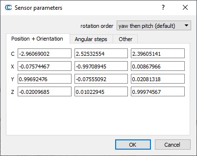

When you edit/modify the sensor object (Edit > Sensor > Edit) do you read at least the right 'center'?
Laserbrain
Posts: 51
Joined: Tue Sep 30, 2014 6:13 pm
Re: Create sensor from e57
Post by Laserbrain »
I didn't know about that feature. Here are the sensor parameters for that same scan:
Posts: 8247
Interesting... I'm not sure where the difference comes from. Can you maybe send me your file? (admin [at] cloudcompare.org)
