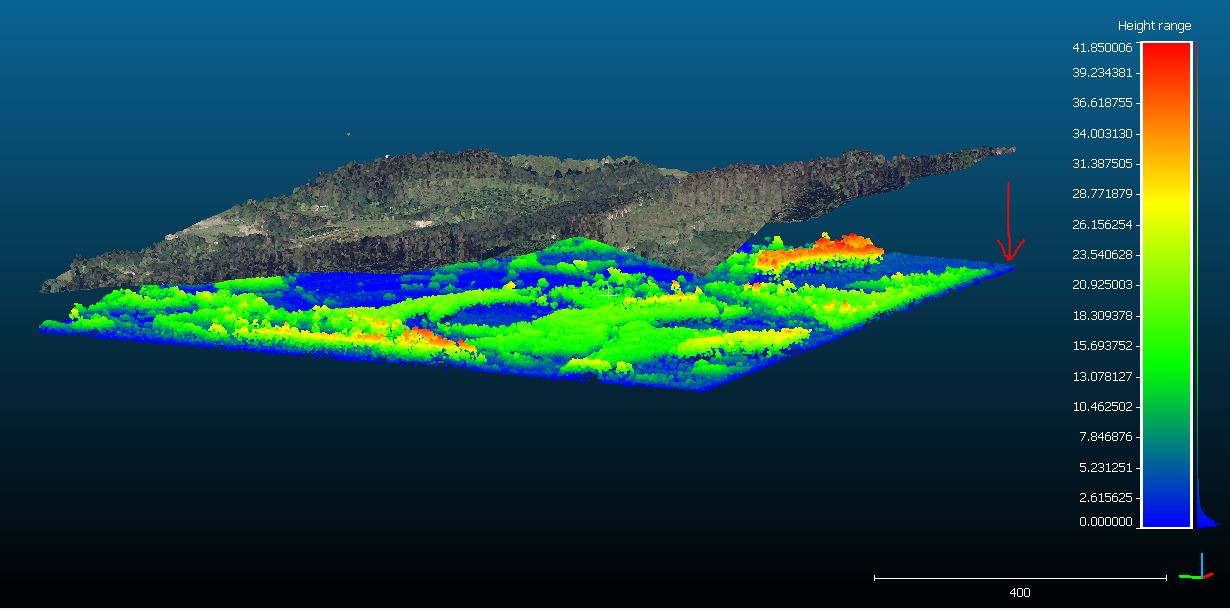

1) use the Rasterize tool: if there's enough ground points below your vegetation (i.e. a good lidar cloud with enough penetration) then you can simply rasterize the cloud and export the resulting grid as a cloud exporting the 'height range' scalar field:
If you have both ground points and vegetation points in your cloud, then you'll get in this scalar field the difference between the two. You can then export scalar field as the Z coordinate:
2) if there's not enough ground points (i.e. there are holes in your ground cloud), then you'll have to fill them by triangulating the ground points first (e.g. with the Delaunay triangulation tool, or with the Rasterize tool once again, by using the 'Interpolate' mode for the 'fill empty celles' option). In the first case, you'll have a mesh that you'll need to convert to a dense cloud (Edit > Mesh > Sample points). You can then either merge the two clouds (filled DTM + vegetation) and use the method described above (1). Or alternatively use the 'Compute 2.5D Volume' tool that does the same but between two separate clouds (you can export the 'difference' raster directly)

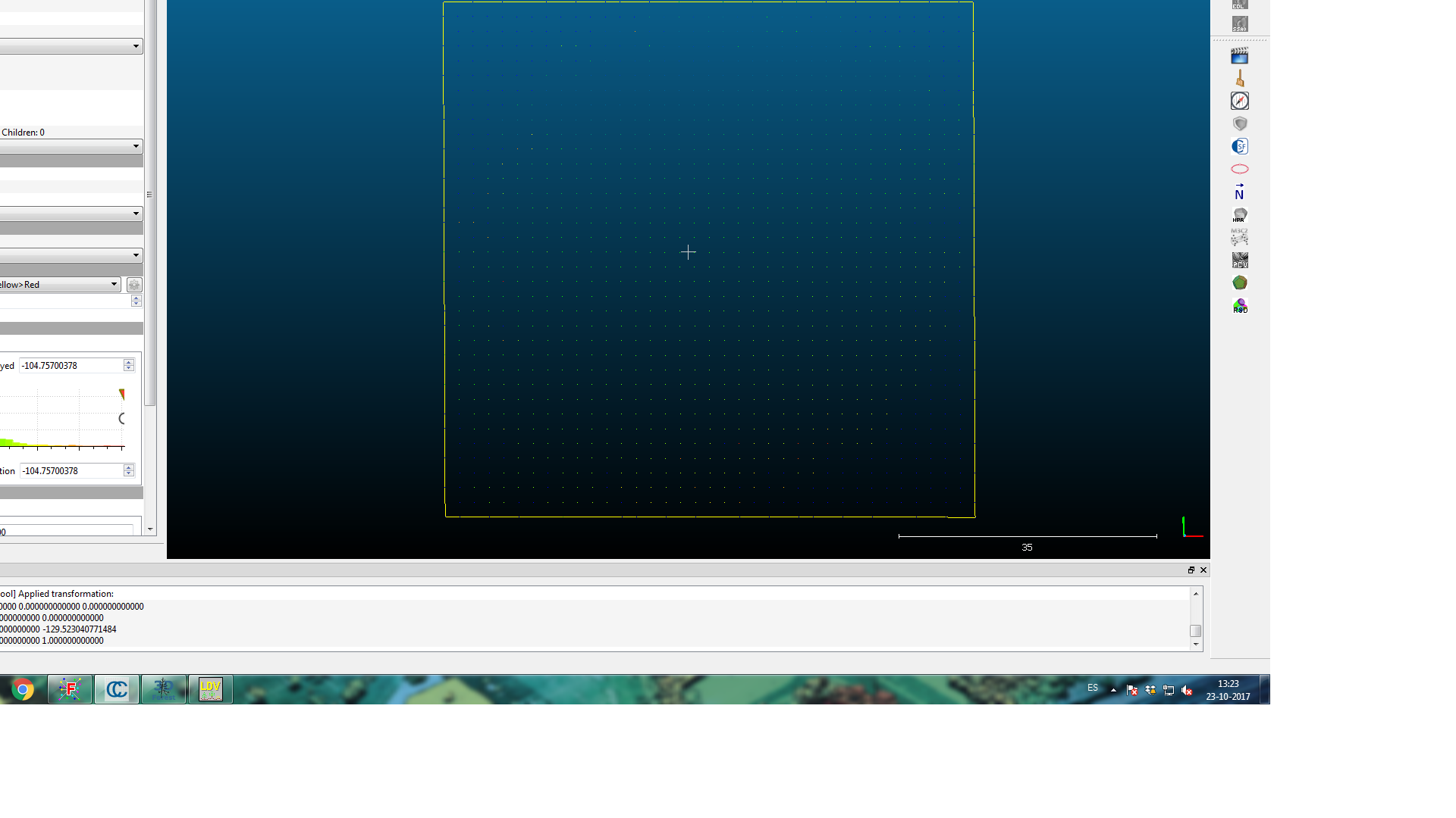

Sorry, I did not see that you responded to my last post. Yes you are right, I want to 'subtract' the DTM from the DSM, so that only the vegetation is left. I am following your steps but am not getting the results I need.
1) I am using LiDAR data from terrestrial scanning, so I am not sure if everything works the same.
2) The image that you posted where it shows the raw data being turned into a DSM, I cannot figure out how how to do that.
3) Are these steps correct? rasterize the data: Tools>Projection>Rasterize(and contour plot)
step: 2
Active Layer: height grid values
Direction: Z
Cell height: Minimum height
interpolate SF(s): average value
re sample input cloud: checked
Fill With: leave empty
Update grid
Export tab>height range checked>Raster>Export heights>OK
This is the results I get:
Thank you so much for your time. I am very new to this kind of work and have little to no guidance. So this is a huge learning experience.

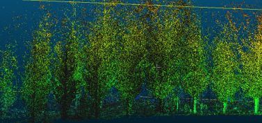

I figured out what was going wrong. I wasn't activating the "Scalar Field" in the properties Scalar Fields section. I have made the dsm. The problem I am having now is that all my trees are being stretched in the Z dimension. Have you seen this problem before?
Re: DEM
Can you show me what it looks like?
Sile
Posts: 21
Joined: Tue Oct 10, 2017 3:40 pm
Re: DEM
Post by Sile »
Here is what I have.
Re: DEM
What am I looking at?!
Are you sure you are projecting along the right dimension? Or using the right scalar field?
