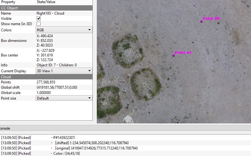

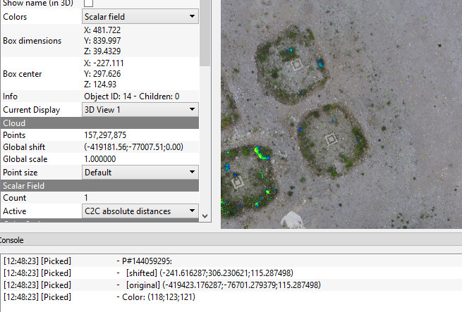

i am trying to export only the picked points, not the cloud and there is the problem. the problem is solved if i go to global shift and delete the minus in front X and Y coordinate.
you can see the problem in the pictures below. Watch the original coordinates and the global shift.
this is without changing the minus in global shift
and this is when i change global shift with deleting the minus
Re: Global shift- problem with original coordinates
Okay I think I understand. It is normal to have a negative shift (because the shift is added to the original coordinates). The error is that the original coordinates displayed in the console (and on labels) are wrong! So this is only a display issue. If you export the cloud with the negative shift, it should be ok (you should be able to test it by saving the result as an ASCII file).
