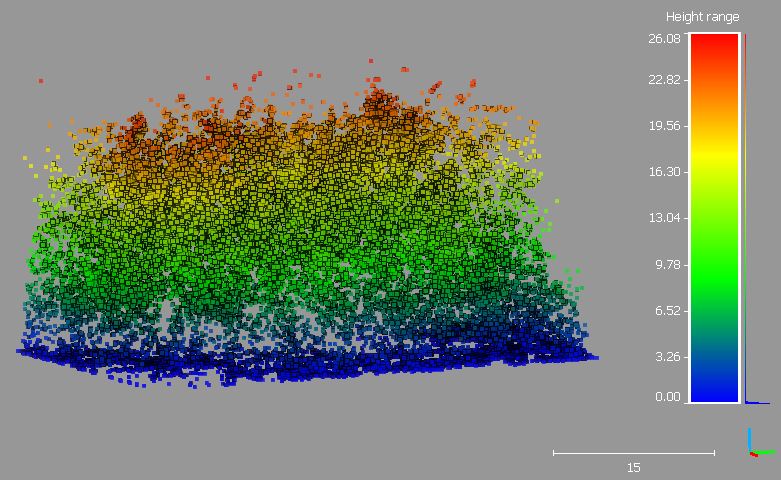

Re: DEM
Posted: Fri Nov 17, 2017 7:48 am
by daniel
Thanks for the dataset.
I tested the method I described earlier and I couldn't reproduce your result:
- load the cloud
- start the Rasterize tool
- make sure the projection direction is 'Z'
- set the grid 'step' to something not too small (I used 0.1 or 0.2 during my tests)
- make sure the 'height range' checkbox in the 'Export' section is checked
- click on the 'Cloud' button in the same 'Export' section
- close the Rasterize tool
- select the generated 'raster' (cloud)
- change the active scalar field to 'Height range' (see the cloud properties)
- call 'Edit > Scalar fields > Set SF as coordinates'
- click on the 'magnifier' icon to center the camera on the cloud (as its coordinates may have changed a lot)
Here's what I get:
Re: DEM
Posted: Mon Nov 20, 2017 12:24 pm
by Sile
Daniel,
That worked perfectly. The problem I believe I was having was not having the correct Active field selected. Thank you so much for working with me on this problem and I hope others find it useful as well. Cheers!
