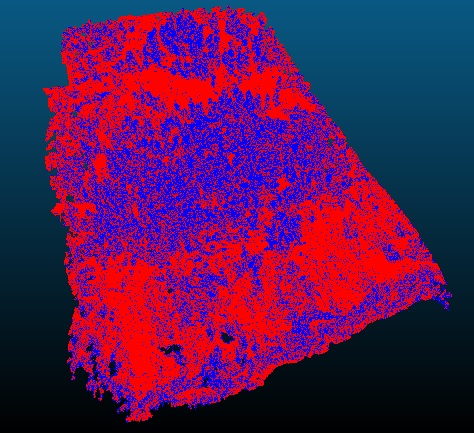

Basically I'm a geotechnical engineer and I'm interested in extracting bare-earth models for slope and other analysis. I've used qCANUPO to classify my point clouds, however, I couldn't figure out how to separate/delete vegetation from the ground (bare earth) points after classification.
I really want to see and export (as laz or laz, dwg) a colored (point cloud has sRGB properties) bare-earth model after classification. Or if there's is an option where I can check or un-check the vegetation after classification. Please see attached images for reference.

Once you have generated the classes (as a scalar field), simply use 'Edit > Scalar fields > Filter by value' (and set the interval corresponding to the right class).

Hi Daniel, thanks for your reply. In values what should I enter for minimum and maximum?

Simply the class you want to extract (the same value twice).

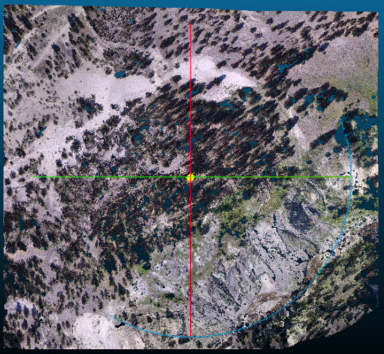

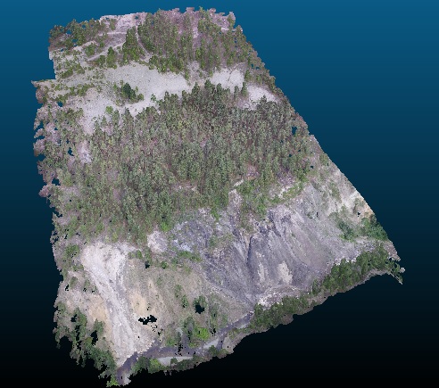

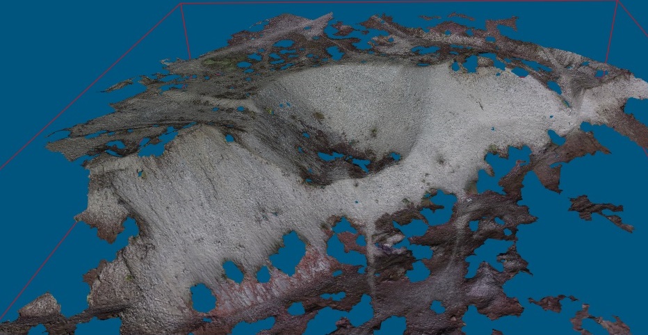

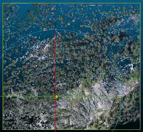

For flat to generally undulating areas, the results have been amazing I've extracted bare earth model, that is good enough for my project (Figure 1). Area looking black are actually tree shadows and not trees. However, for relatively steep slopes with thick tree cover and/or surface erosion debris, there're certain points which were classified into vegetation but actually correspond to earth/ground, e.g. For one such area in the project site, post classification results are shown in Figure 3 (Bare Earth) and Figure 4 (Vegetation).
In Figure 4 you can see that there points (white/brown) that should've been classified as bare-earth but weren't. Could you guys suggest what is the pblm here? The scale for my classifier varies from 0.10 to 25 with a step of 0.20. I've used upper limit to be 25 because there're certain houses on project site that are close to 25m in length.

I've been able to improve my classifier so that now I over 90% of the ground points in the toe part (as mentioned in previous comment) get classified into bare earth. I should thank you guys again for creating something like this and making it opensource.

I tested your plugin today on Photogrammetrically point cloud consisting of over 80 million points, and I must thank you that it worked better than my expectations, for very irregular surfaces (e.g. erosion gullies with very sharp spikes) it CSF performed very well. However, the settings I used were 0.2, 800, and 0.5 (with both steep slope options checked). I actually moved step by step from cloth resolution of 1 to 0.1 while keeping all other values constant, and until 0.2 my bare-earth model constantly improved. However, when I changed from 0.2 to 0.1, my bare-earth model had less points (especially in areas with erosion gullies), what I got for 0.2. Do you know if there's any specific reason behind that?
