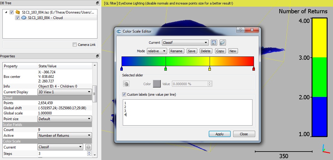

Alas, I've add some time to take care of the 'custom labels' feature (during a very long train trip between Hamburg and Grenoble ;).
The user can now specify a list of 'custom labels' for each color scale:
I've updated the latest online beta release (see the download page).
