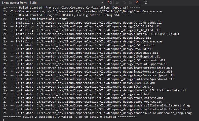

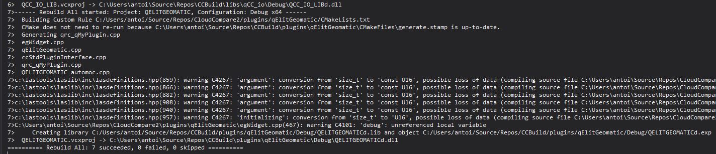

I have a plugin project that compiles "apparently" without error, as you can see below.
The install build seems also ok
And the compiled plugin is copied into the final folder.
