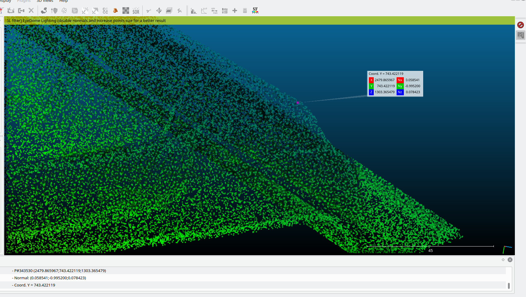

Hi everyone!
I want to use CCLib to display labels at certain points on my cloud. I want to achieve something similar to what happens when you use the Point picking tool.
As far as I know, the functions related to display labels are connected to the point picking process but I want to establish the labels position after some calculations and not after an user interaction.
In resume, the function I want to create should be similar to addLabel(Vector3 point_posc, string text) and show the label at the closest point of my cloud to the given position.
Is there a direct way to do this? Can I generate a PickedItem from a 3D position? Does anybody has a better approach?

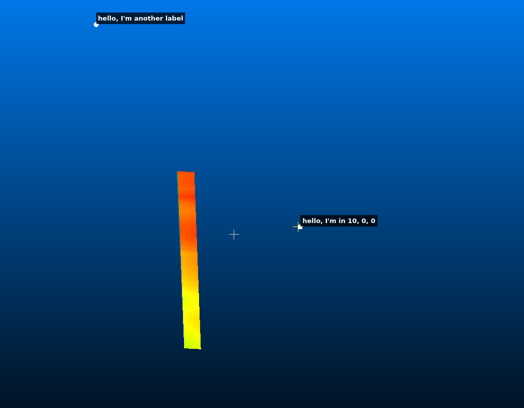

An my results are something like:
It's an advance, but I don't know why my tags don't show the coordinates of the points as in my first post. Also, my labels can't be moved or minimized with the mouse and aren't connected with the marker.
I haven't found what part of the code is responsible for this stuff. Can you (or someone) help me?
Re: Adding labels
'Point legend' is the name (title) that appear next to the point.
What you want is actually to display the 2D part of the label:
Code: Select all
newLabel->setDisplayedIn2D(true);
alvarofergar
Posts: 10
Joined: Wed Mar 13, 2019 12:07 pm
Re: Adding labels
Post by alvarofergar »
The setDisplayedIn2D(true) method didn't make any change.
With a derived class to access the protected members, I have also tried setting the m_showFullBody boolean to true and using the drawMeOnly2D() method, but I always get the same result.
