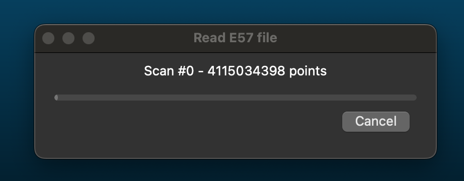

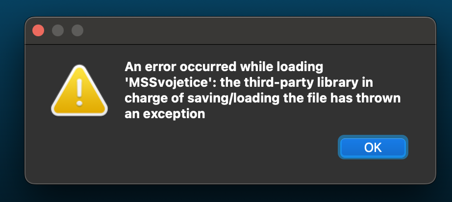

I have a same issue, when importing e57 received from colleague from cyclone register I can't open it. I tried to install latest beta as you recommended below, but it didn't solve the issue. We tried to solve it with our local Leica scanner provider but nothing helped. Did you find some way how to fix it? Thank you very much for your time.

Ah, 4billions points is way above CloudCompare's pay grade! There's a theoretical limit at 2 billion points per cloud, but not a lot of machines would be able to load such clouds anyway... I bet we could at least add a warning about that even before trying to load the cloud.
Or support 'slicing' of the cloud in smaller ones, as we do with other formats (E57 and LAS I believe).
