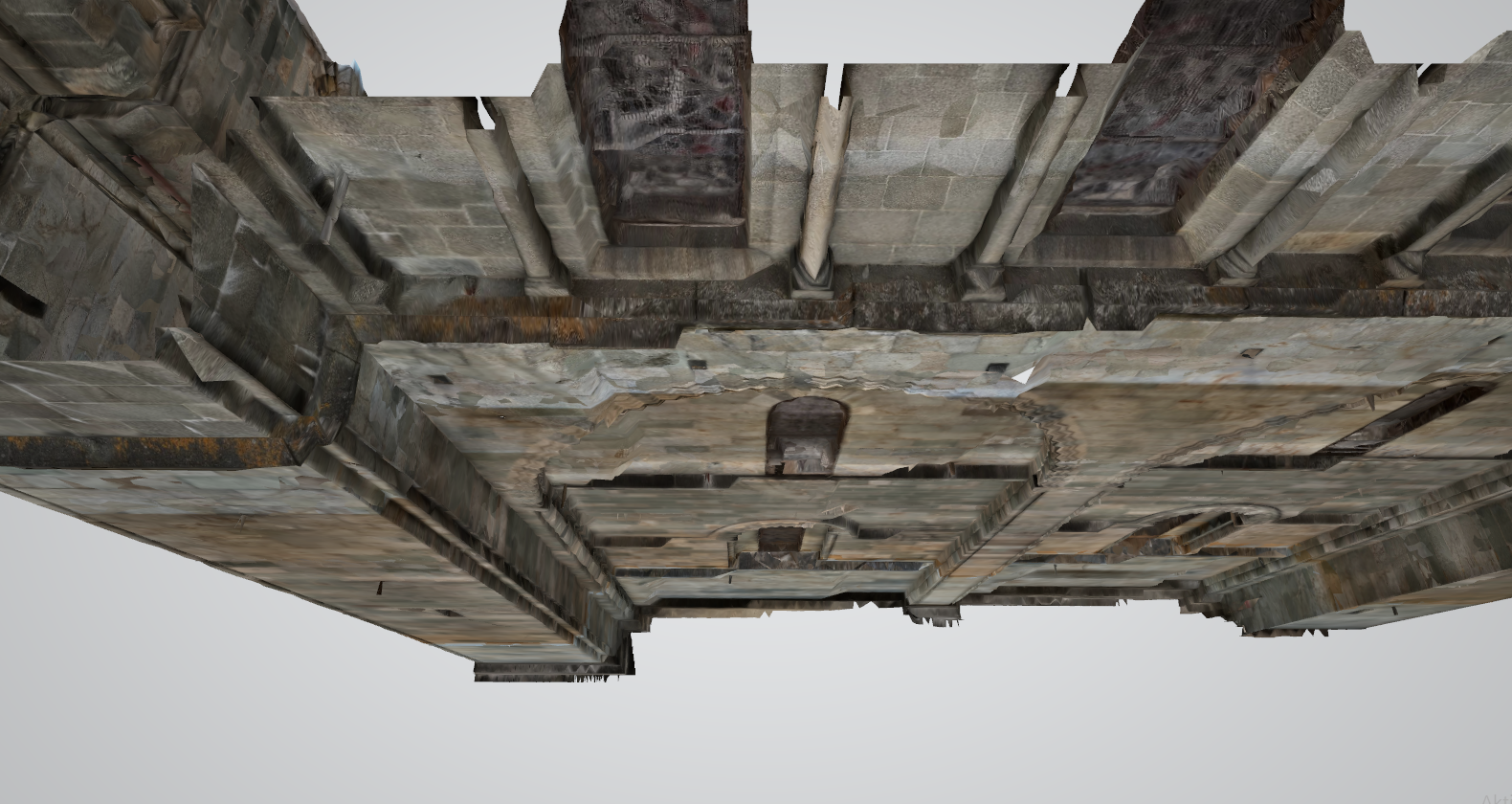

damaged obj saved from CC

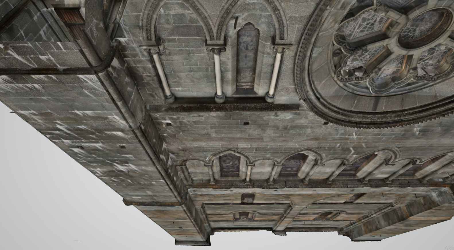

Original Obj created in agisoft

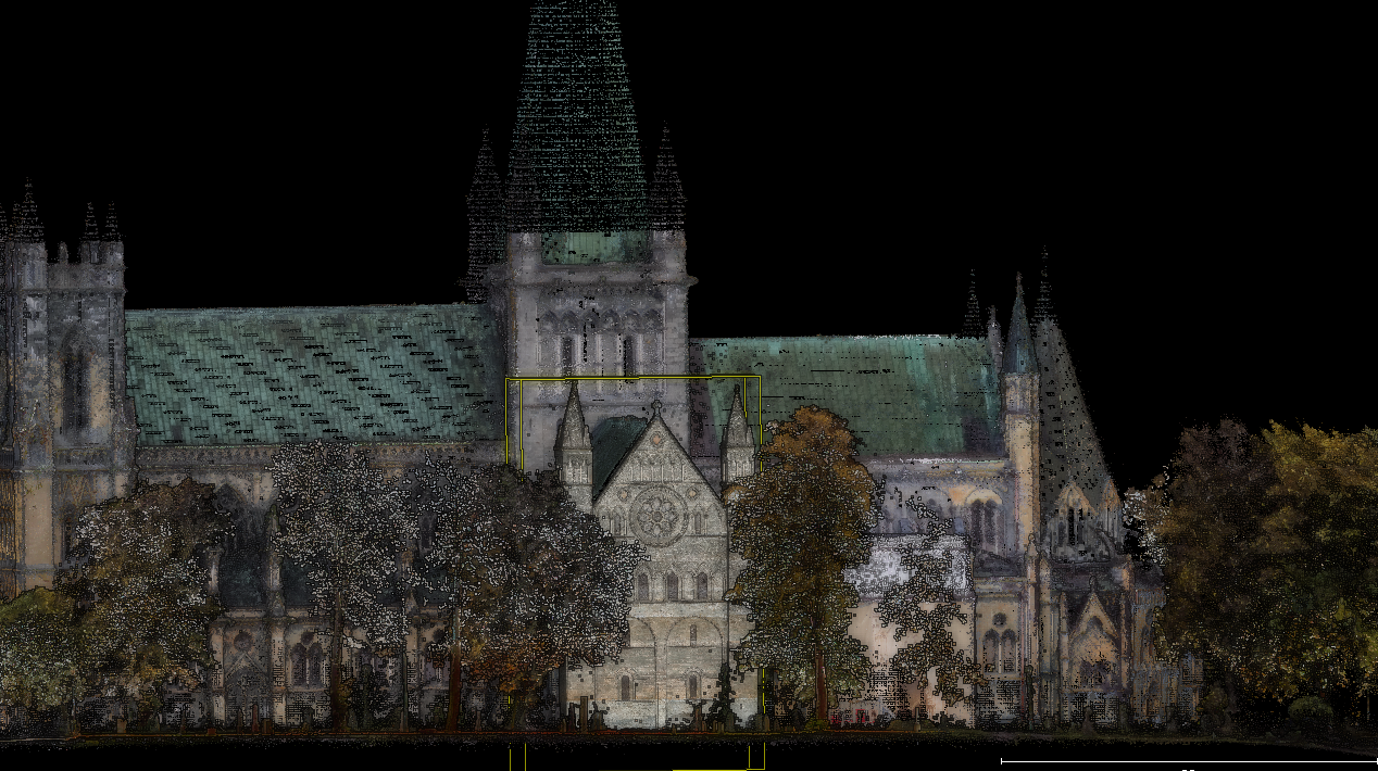

Obj with edited shift and scale aligned to a pointcloud.

If you open the file again in CloudCompare, is the model damaged, or does it still look ok?
Because I wonder if the other tool is properly managing large coordinates? (OpenGL for instance doesn't like large coordinates, and it creates rendering issues due to the truncated coordinates).

It’s looking good in CC. Also in agisoft.
In windows 3d-viewer and meshlab it’s not.
Is it possible to not save as large coordinates, or you know other workarounds?
