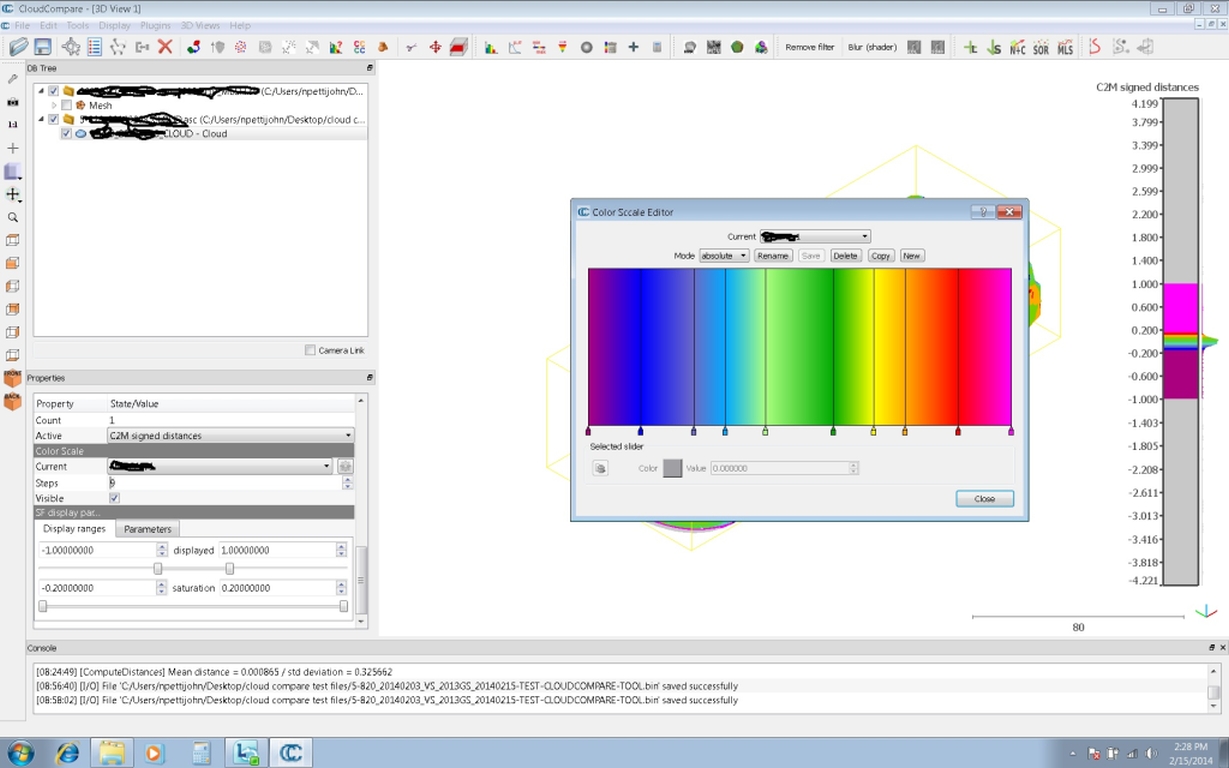

the color ramp display is not adjusting when I change the scalar field display parameters "displayed" range. When I reduce the displayed range, the color ramp maintains the larger range and grays out the values beyond the smaller displayed range values that I input. Therefore the color scale steps are not defined/identified with individual numerical values in the color ramp....instead they are all lumped within a large range of +-0.2000.
color scale ramp
color scale ramp
color scale ramp question.jpg (251.5 KiB) Viewed 26398 times
Re: Scalar field
Posted: Sat Feb 15, 2014 7:51 pm
by npettijohn
OK....figured out I needed to uncheck box under Parameters tab "show NaN/out of range values in grey"
