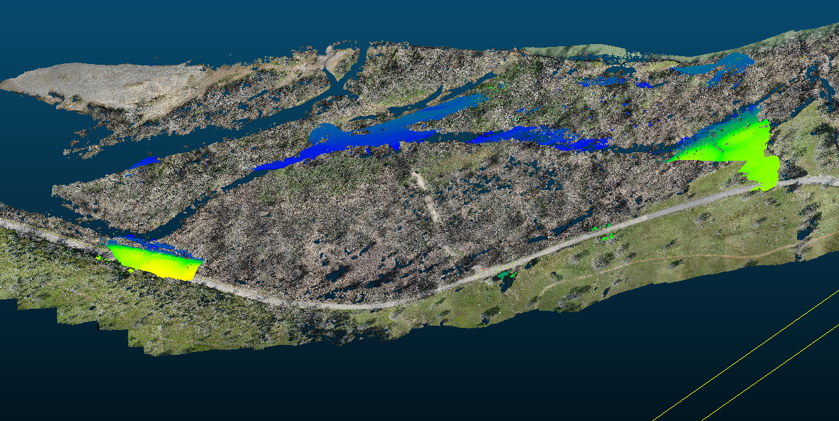

This is an image I aligned with the rotate and translation tool, green being the image I am aligning and the RGB layer the reference image

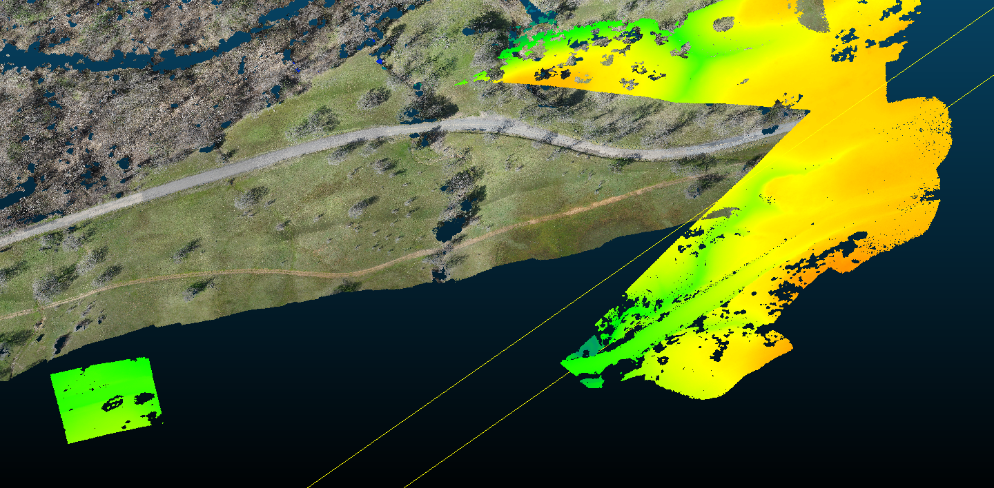

when I went and did a fine registration without scale adjust, it placed the layer to aligned in a wrong position

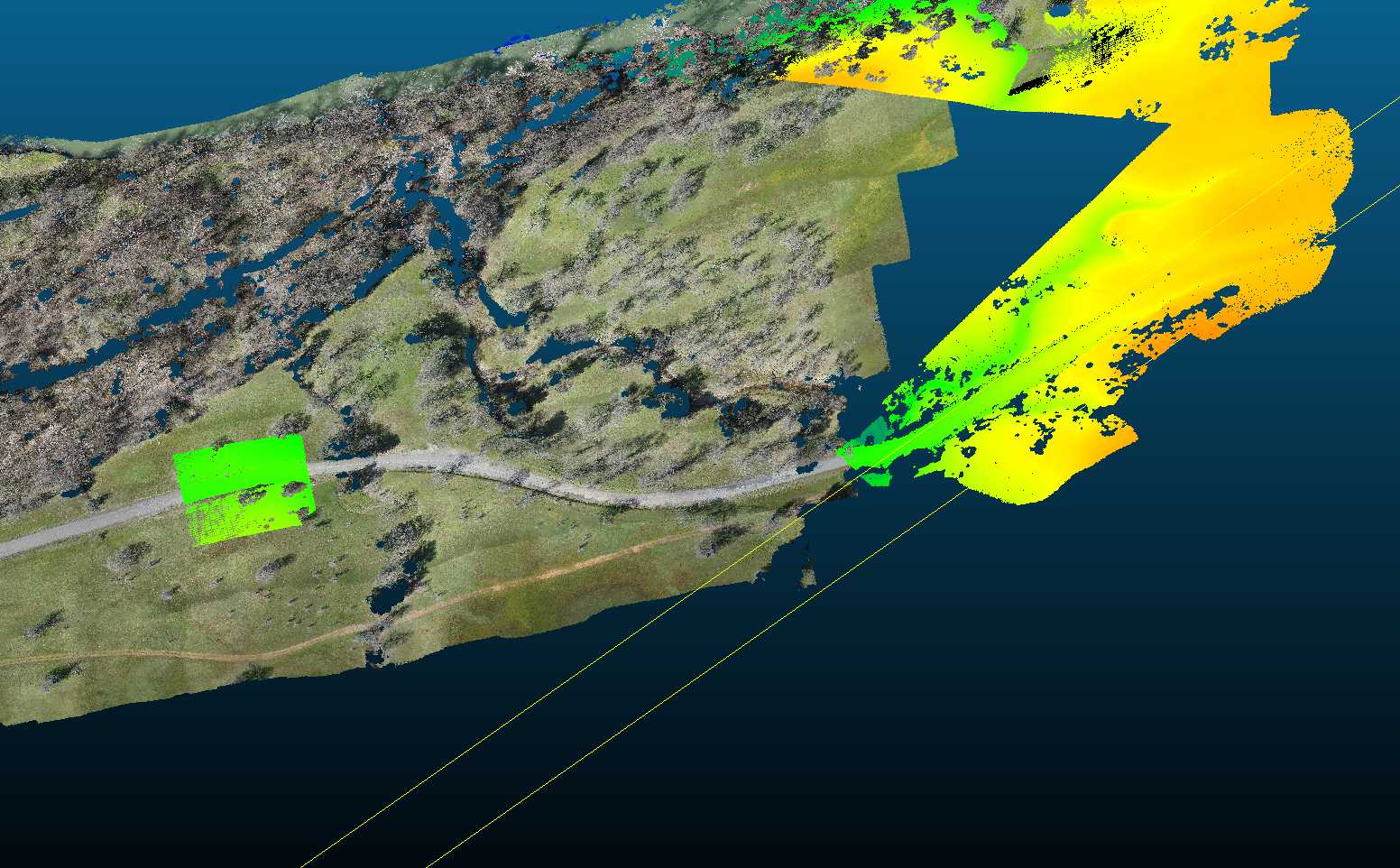

and when I chose fine registration with scale adjust, it shrank the image to be aligned (seen peeking out at the edges of the reference RGB image)
The images I am aligning are lidar from UAV flights with problematic real time kinematic data.

Have you set the overlap parameter correctly? Because from the image of the starting position, it seems the overlap is very small. You should set this parameter accordingly (otherwise will algorithm will try to make all the points of the 'to be aligned' cloud as close as possible to some points of the reference cloud.
