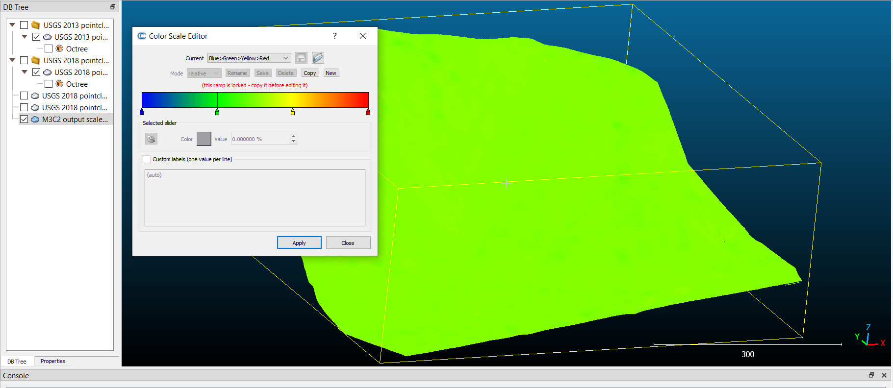

Thank you. I was able to reduce the core point generation. However now I am having trouble trying to display the color scale.

You simply have to check the 'Visible' checkbox in the options:

I don't see an option for 'visible' anywhere, however I think I can see the difference now, not sure what changed. I also see these white circles that are spaced out evenly throughout. Also, how can I get the scale legend to populate? Thanks.

So the 'Visible' option (and all color scale options as well) are in the cloud properties (on the left side, below the DB tree, once a cloud is highlighted.
And you can create an absolute color scale, with labels, etc. with the 'Color scales manager' : https://www.cloudcompare.org/doc/wiki/i ... es_Manager
And I have no idea where these small circles come from!

daniel wrote: Tue Apr 09, 2024 8:14 pm So the 'Visible' option (and all color scale options as well) are in the cloud properties (on the left side, below the DB tree, once a cloud is highlighted.
Thank you so much for your help. One last question, is there a way to change the view of elevation change from 3D to a 2D view, keeping the color scale overlaid over the cloud?
Also seems like those gray circles are areas with no data (NAN).
