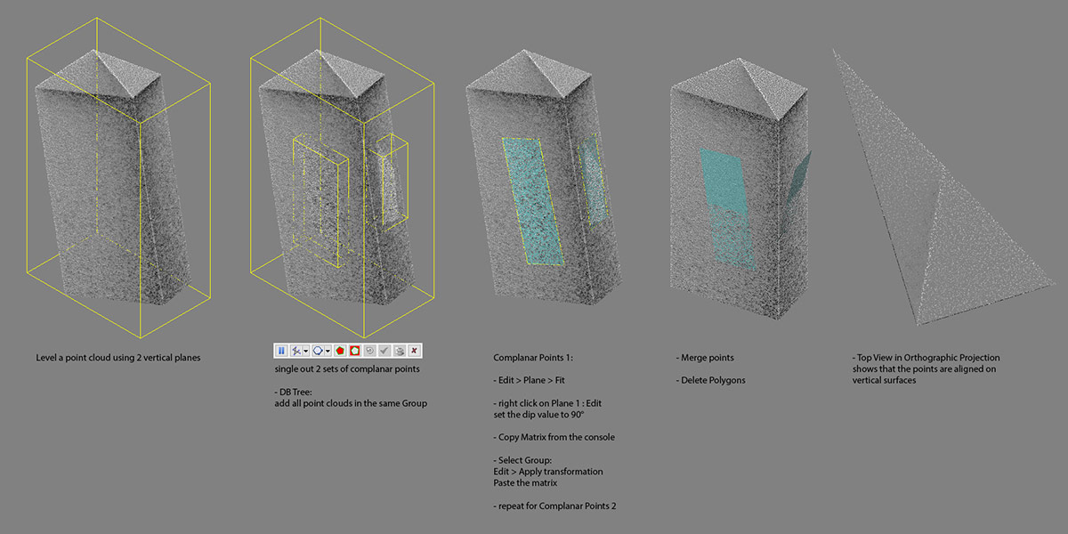

Merci Daniel! The trick works like a charm. I combined screenshots to make it fast to understand for other users:

Thanks for the image. I'll add it to the wiki documentation of the level tool.
