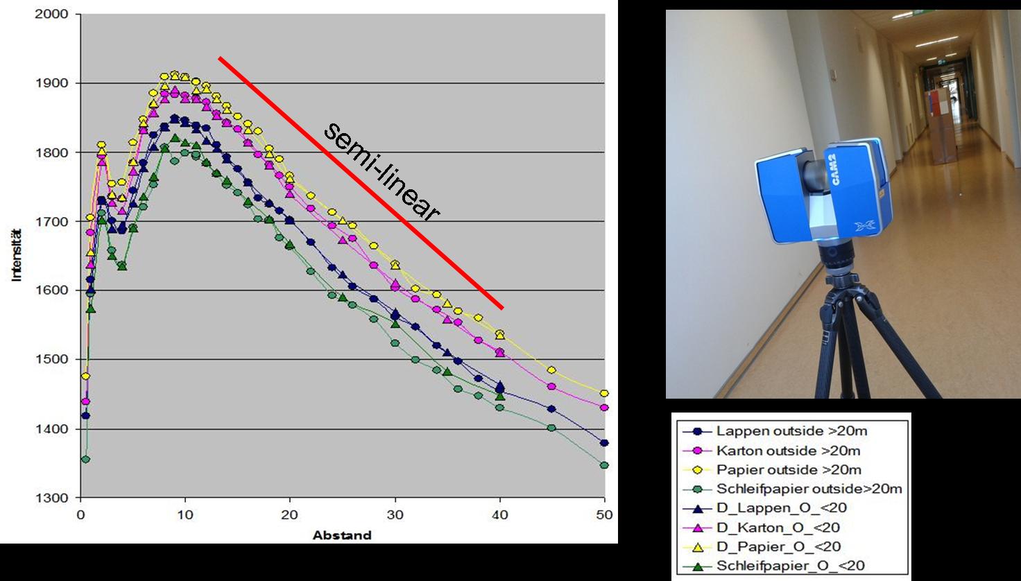

below is a graph showing intensity versus distance of the scanner to the scanned object. What I have done is that I used a box with four different surfaces and placed it at different distances to the scanner. For each distance I took a scan and plotted the average intensity for each surface (material). As you can see from the plot, the intensity changes with the distance. The "ratio" or curve is very complex in the distance range between 0.6m to 10 m, but becomes semi-linear between 10 m and 40 m. For this range it is possible to calculate a simple function which you could use in CC to recalculate the intensity . Please be aware that this function might change slightly when your scanner gets re-calibrated during a service for example.
