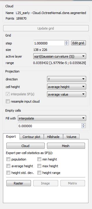

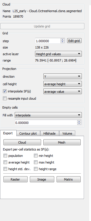

I came to use rasterize tool on cloudcompare. I have questions regarding its image output. I noticed that we can output the raster as image when I choose height grid value. However, when I choose Gaussian curvature value or any scalar field value, the image output button isn't clickable. I am curious if this is the case or anyway I can export the raster to image for other scalar field values?

for your reference.
Re: Rasterize tool: Image output
Hum, you are right sadly. I thought someone updated the code since then, but apparently not! The 'Image export' option still doesn't handle scalar fields (only the altitude).
