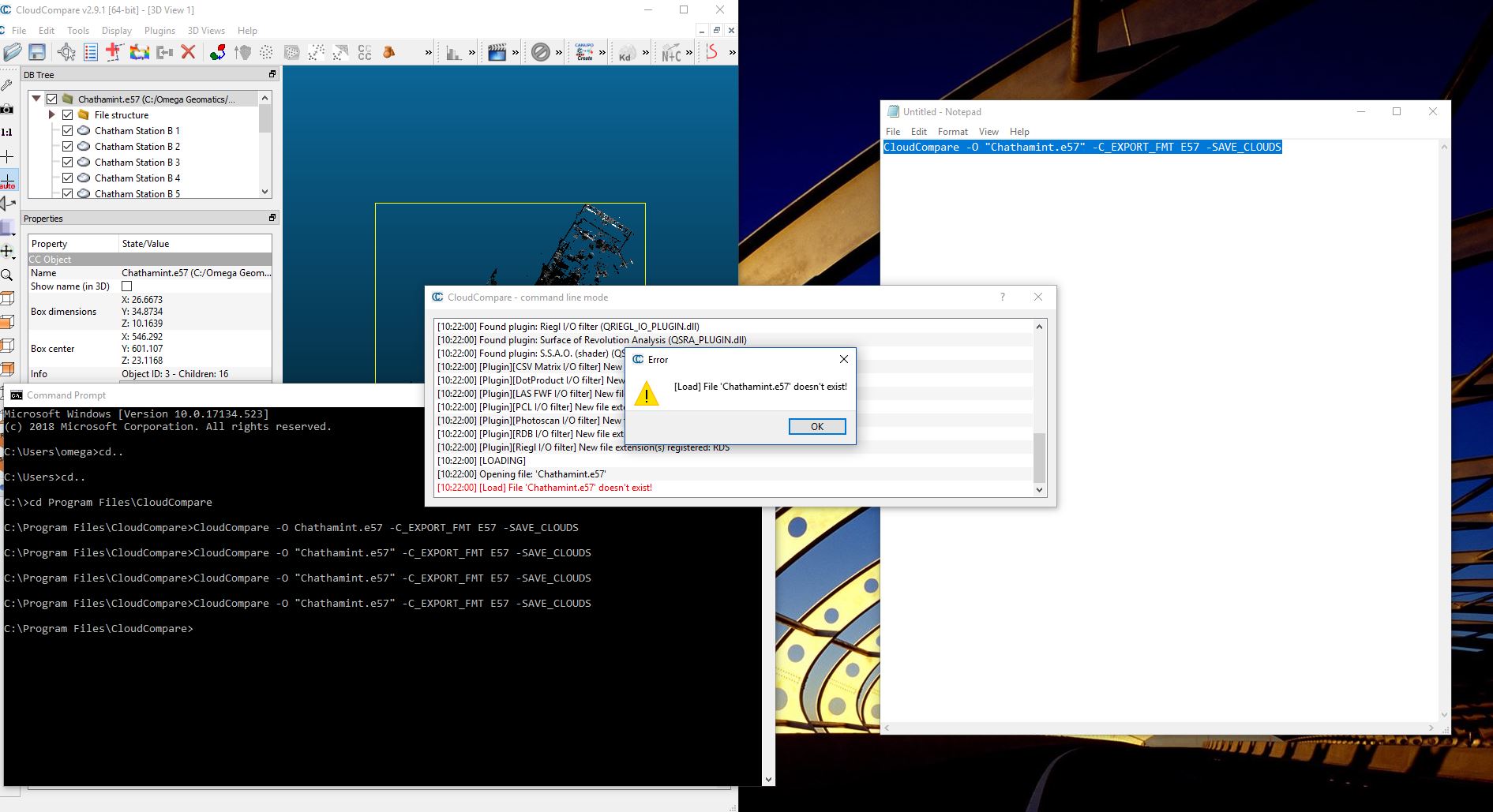

Hi Daniel, I have tried that and its not working? I am guessing it may be to do with the file name then? I took the spaces out and it still didn't work?

Re: How to separate e57 files
You probably need to specify the complete path to the file: e.g. "C:/XXX/YYY/ZZZ/Chathamint.e57"

Ah, yep that’s got it.
