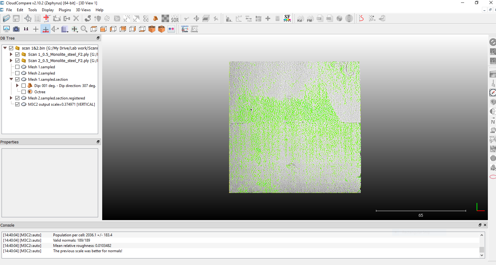

Here is a screenshot:

Re: M3C2 and volume calculation
"Default" is 3D. That means that the normal is point in any direction (it's actually the normal to the surface, so the direction will depend on the surface).
And for the overlap, it seems you do have nearly 100% here. But also the two clouds seems so close that you must mainly measure noise! Hence the sensitivity to the parameters.
