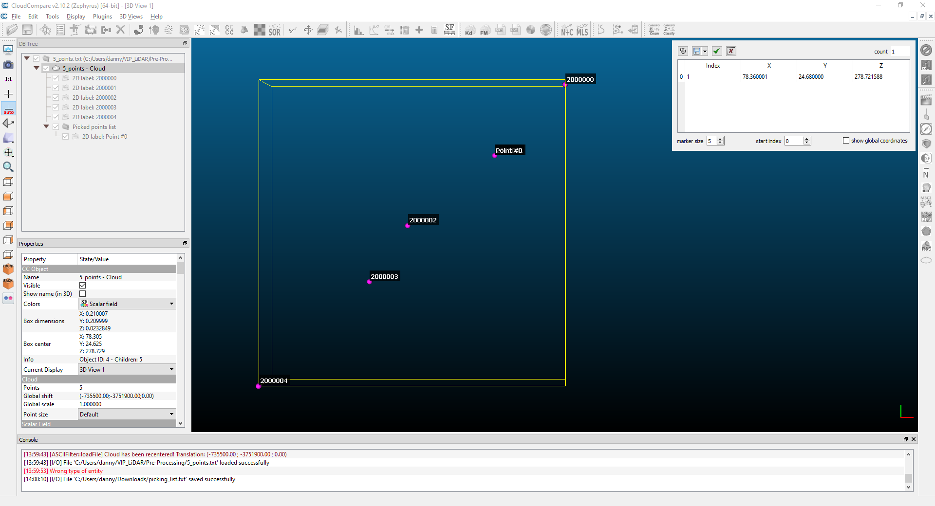

Thanks for the reply. I don't know if CC is reading them in as text or as numerical values. I don't see why it wouldn't read it as numerical values.
My data is in XYZ format in a .txt file. It is essentially the following just in a .txt file:
2000000 735578.41 3751924.73 278.7242 0.224
2000001 735578.36 3751924.68 278.7216 0.349
2000002 735578.3 3751924.63 278.7308 0.333
2000003 735578.27 3751924.59 278.7178 0.345
2000004 735578.2 3751924.52 278.7411 0.357

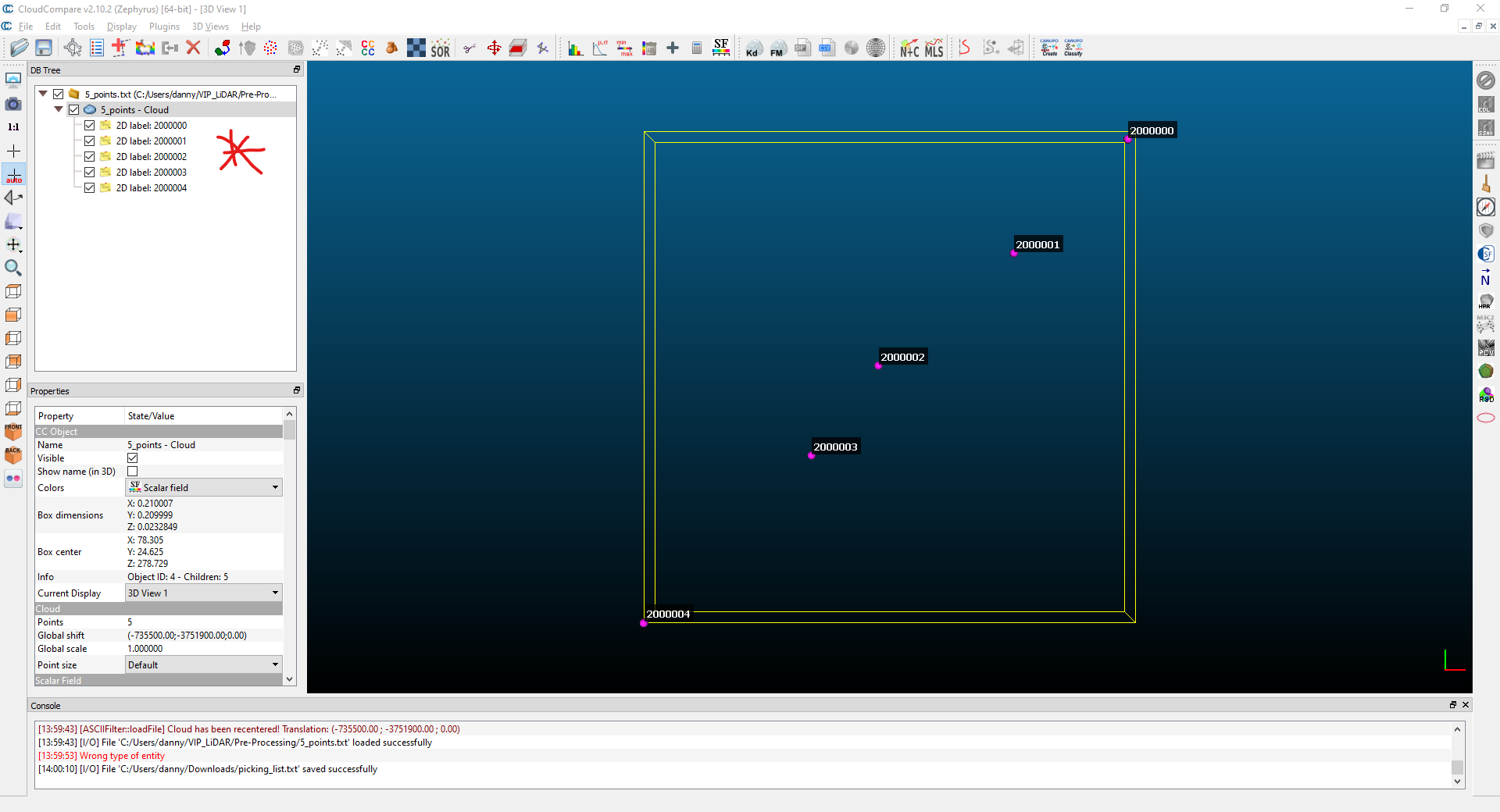

The first column is the unique identifier that I want to be labels. The next 3 are xyz in meters, and the last is a scalar. If I load this into CC, then it generates 2D labels for each point.
When I go to point pick, say point 2000001, then it puts it in a list but gives it a label of Point #0.

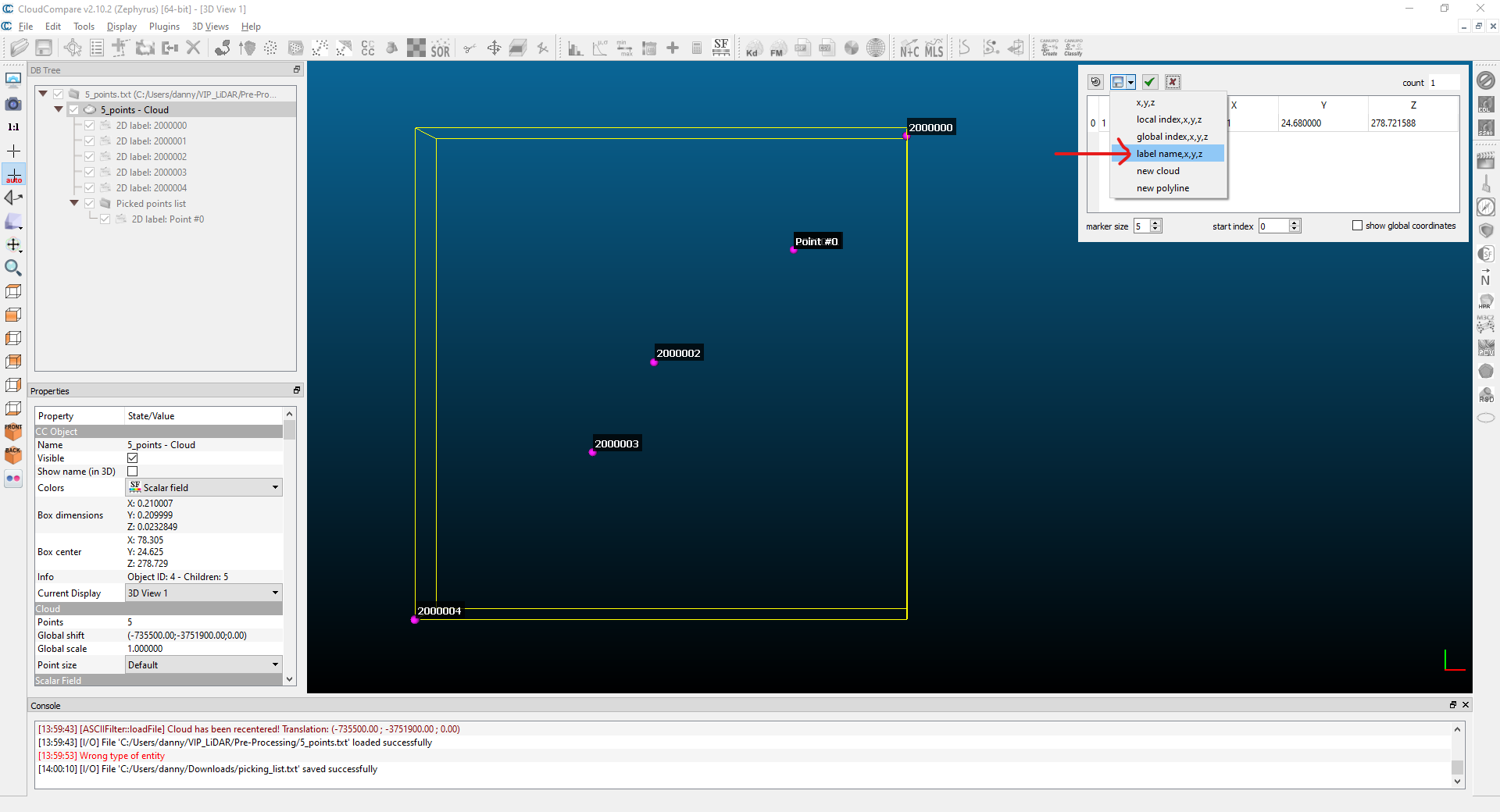

I go to export it and I choose the option "label name, x, y, z" and it exports it with the label name as "Point #0" instead of "2000001".
So I'm not quite sure if my issue is that:
1) My numerical labels are being imported as text.
OR
2) There is a bug and when you select "label name, x, y, z" to export points it doesn't actually export the labels, but rather the local index.
You can use the data above in a .txt file to see what I'm talking about.

If you chose 'Label' in the 'ASCII Loading' dialog, then indeed, the values or text will be imported as '2D Labels' in CC (and considered as text). 2D Labels are actual entities, below the cloud, but they are more or less independent.
When you use the point picking tool, it only applies to the cloud. It doesn't care about the potential 2D labels associated to the cloud. So it creates its own label (from 1 to N). And those are the labels you can export afterwards (it's probably confusing ;). It's not a bug.
