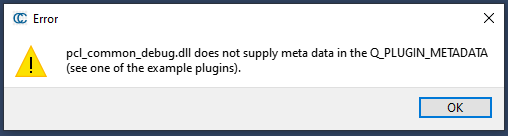

But, when I try to load plugin QPCL_PLUGINd.dll and run CC
this is error message :
thanks Nenad
Re: PCL plugIn
Have you copied the PCL DLLs next to the plugin? If yes, you should actually copy them next to the CloudCompare.exe executable.
Otherwise CC will try to load them as plugins...

I did what you wrote and that solved error message.
Still, CC does not load plugin QPCL_IO_PLUGINd.dll
