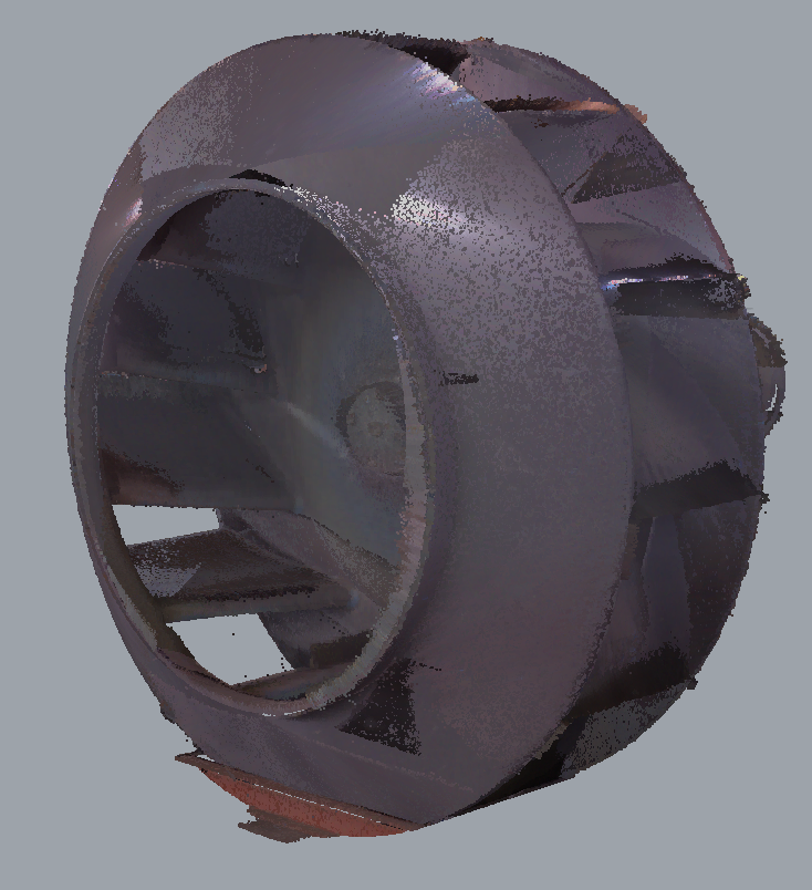

Please advise whether it is possible to process an 357 scan (BLK Leica) to Stl?
Re: Convert e57 to Stl
Well, you will have to compute the normals first (with 'Edit > Normals > Compute'). The hardest part is to get all the normals properly oriented...
And then you can use the Poisson Reconstruction plugin that should work pretty well (see https://www.cloudcompare.org/doc/wiki/i ... n_(plugin)).
