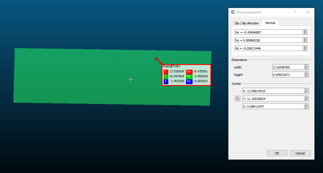

I want to compare two fitted planes based on their parameters (normal vector and orthogonal distance to P(0/0/0)). Therefore i checked, if i can use the given center of the planes to calculate the orthogonal distance (ax+by+cz=d), by comparing the result (d) with the distance of a manual picked Point of the plane (Point Picking). By donig that i found out that the in the point picking progress shown normal vector isn the same as the calculated normalvektor of the plane. There is a slightly difference. Is there any Reason for that ?

I read the Plane center and the normal vector out of the Plane Properties (right click on the Plane in the DB Tree -> Edit) as shown in picture a attached. Is the center only the center of the Box and not a point on a plane ?
The second thing i was wondering why the shown normal Vektor in the plane Properties ist different to the shown normal vector of a random picked ponint of this Plane.

- Ponint_picking.PNG (32.21 KiB) Viewed 4662 times

No it was just to be sure. The center in this 'Plane properties' dialog is the right one.
The normal vector displayed in the 2D label is actually the interpolated normal of the triangle that is used to represent the plane. This is why you have small differences. But you should of course prefer the plane normal (from the plane properties). We should definitely improve that (i.e. use the real plane normal when available, and not the 'generic' triangle normal).
