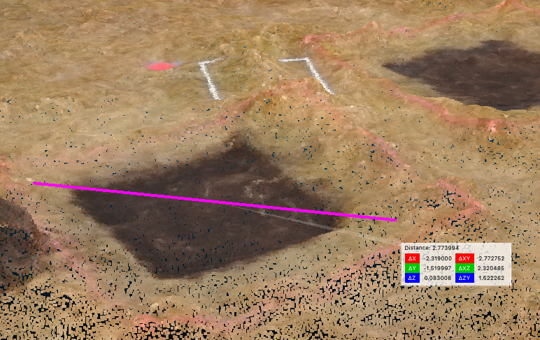

Hey Guys. I have connected 2 points as a segment using the point-picking toolbox. The total span is 2.7 metres over a depression in the ground. But I want to split that 2.7 metre vector into small segments so that I can place additional measurement points beneath it in the depression. Can I split an existing vector at a chosen increment? Or is there a ruler that tracks distance as you drag a cursor along a vector?
Measuring increments along a vector
- Screen Shot 2021-02-05 at 7.35.00 PM.png (474.49 KiB) Viewed 2782 times
Re: Measuring increments along a vector
Nope.
The "Trace Polyline" tool can "over sample" the polyline you draw between two points. But it might 'snap' to the cloud, and also you won't be able to read the length of each sub-segment...
Not sure as I'm not an ArcMap user but you should try .shp or .dxf if it's vectors?
