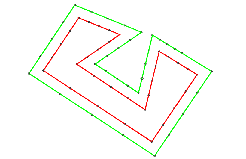

Hi
I have perimeter points (green)
Please how to offset these points to (red)
I tried SCALE but it is not the right tool
Points.zip
(447 Bytes) Downloaded 1097 times
WargodHernandez
Posts: 187
Re: How OFFSET perimeter points
Post by WargodHernandez »
Maybe Daniel can correct me if I'm unaware of a CC tool to do this, but I don't believe perimeter offsetting is available in CC.
you can try out http://www.angusj.com/delphi/clipper.php or github version of the same tool https://github.com/skyrpex/clipper and see if the tool gives the results your after. If it does then someone could possibly look into making a CC plugin
DA523
Posts: 186
Post by DA523 »
CLIPPER is exactly what I need but it is not easy to use .
its binary program can not load or save any dxf svg etc
Sadly, I confirm that CC cannot do this...
