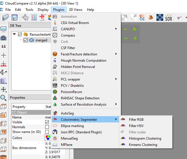

I have point cloud and want to delete all white color point(poles). How one can delete the points?

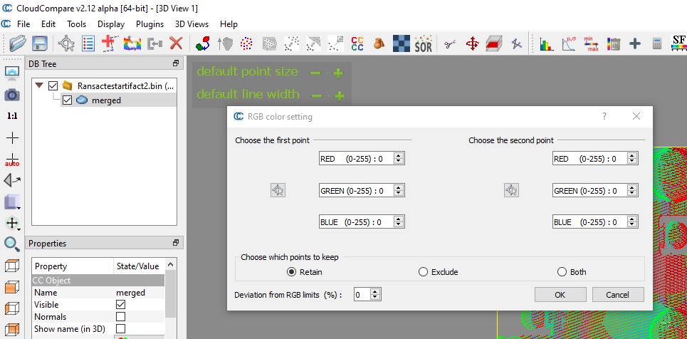

You can use the Colorimetric Segmenter/Filter RGB plugin to do this have the First and second RGB values 250 and 255 respectively and then use the exclude point option.
