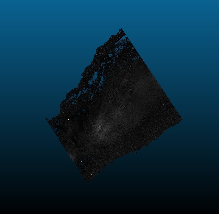

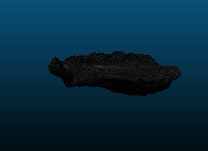

Thanks DA523 for your reply! I don't know if this method can work well due to the very complex geometry. You also told me that this approach does not work if you have more than 2 points with the same Z (i.e. more than 2 ceilings). Is there no way to calculate the tunnel mesh and then find the volume with Edit -> Mesh -> Volume? The two ends of the cave are cut according to a vertical plane (I am attaching a screenshot). Isn't there a way with other software to put a cap on the two ends in order to close the mesh and then calculate the volume? Thanks again. Any advice from you is greatly appreciated.

Re: Close a tunnel mesh
1- 2.5D volume is the best choice but does not work if more than 2 points have the same Z value (multilayers )
2- Edit -> Mesh -> Volume theoretically can calculate any solid mesh (watertight mesh) volume,however it is very sensitive to holes, nonmanifold and defective faces (wrong order of face points, etc)
(I assume that Mesh -> Volume does not use 2.5D algorithm )
3-Closing mesh is easily done with Blender (the best ), freeCAD or meshlab. but the closing process can generate sometimes a lot of nonmanifold and defective faces so CC can give a wrong volume without any warning
4- Meshing your tunnel pointscloud is the most difficult step ..
Did you get an acceptable mesh despite it being opened at both sides??
Can you post here the mesh in STL or PLY file? ore post some mesh similar to your mesh ..
5- Convex hull meshing by meshlab is a quick way to give a rough volume that is surely bigger than your mesh volume. This helps in case you just need max possible volume
again, Did you get an acceptable mesh despite it being opened at both sides??
