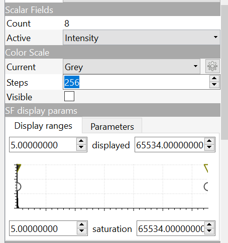

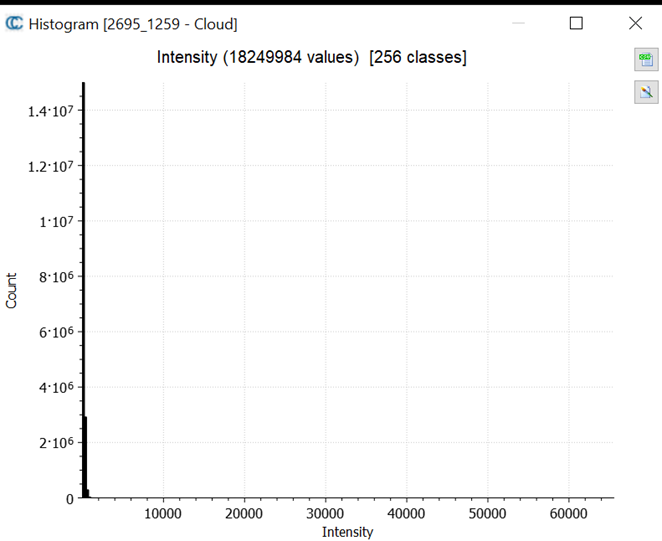

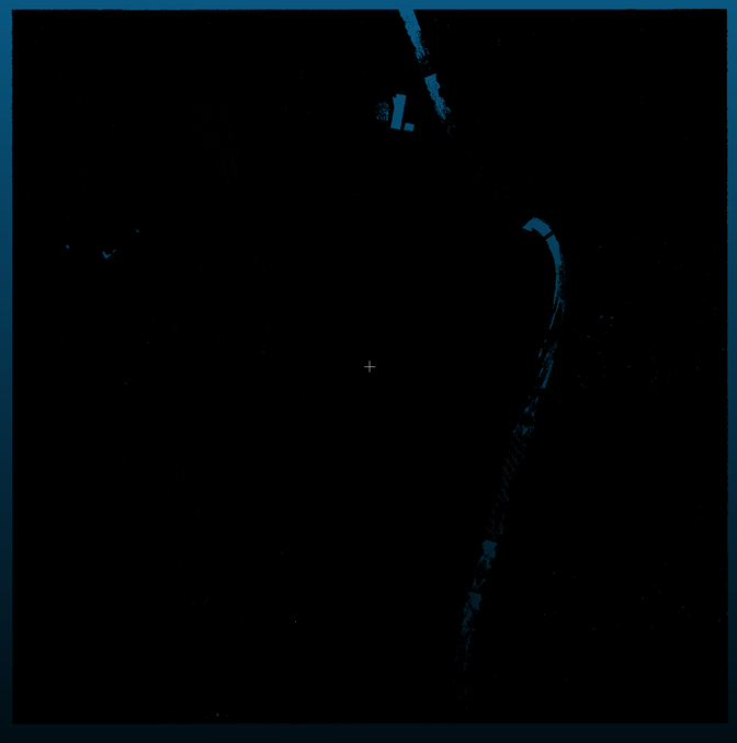

Now I have a problem with the “intensity” in CloudCompare. I used the Sample Data, https://www.swisstopo.admin.ch/en/geoda ... usterdaten and opened the las files. When loading I used Accept all twice and the data is loaded well. But when selecting “Intensity” instead of “PointSourceID” the Display range use the maximum “displayed” and “saturation” value of 65534 and the nothing is seeing on the data rectangle.Manipulation these values to smaller values shows the more but the histogram is still not looking well.
Any idea what could be wrong?
Kind regards and many thank for an answer.
Peter

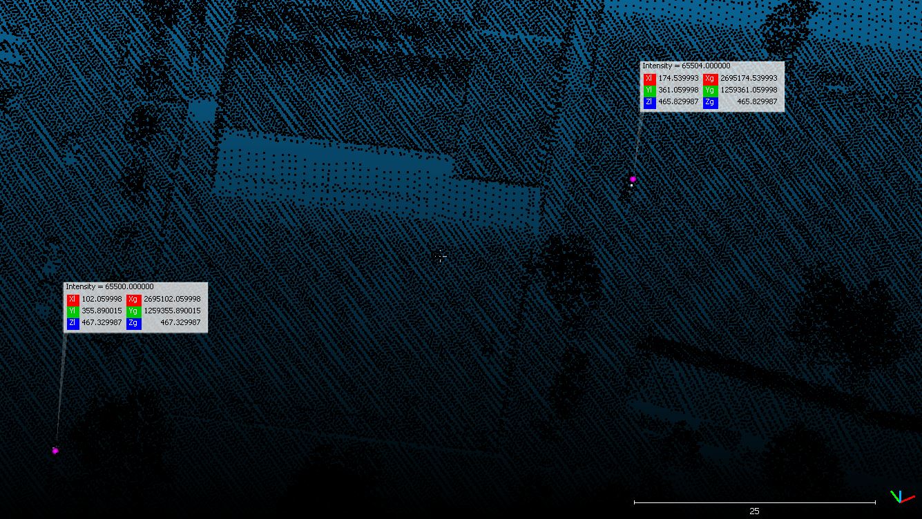

If CloudCompare shows in the scalar field properties a 'max displayed' value of 65534, this means that there's indeed such a value in the data. And that's theoretically possible since LAS specifications expect intensities to be coded between 0 and 65535 (16 bits).
Obviously, in this case, it looks more like outliers. You can see some white points here and there in the cloud with intensities above 65500:

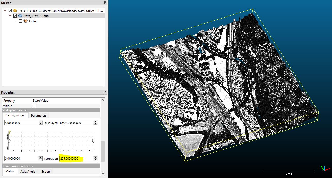

You have 2 choices:
1) the simplest: simply reduce the 'max saturation' value to 255
2) Remove the points with high intensity with the 'Edit > Scalar fields > Filter by value' tool once the 'Intensity' scalar field is active

And to be clear: the issue is with the original data ;)
