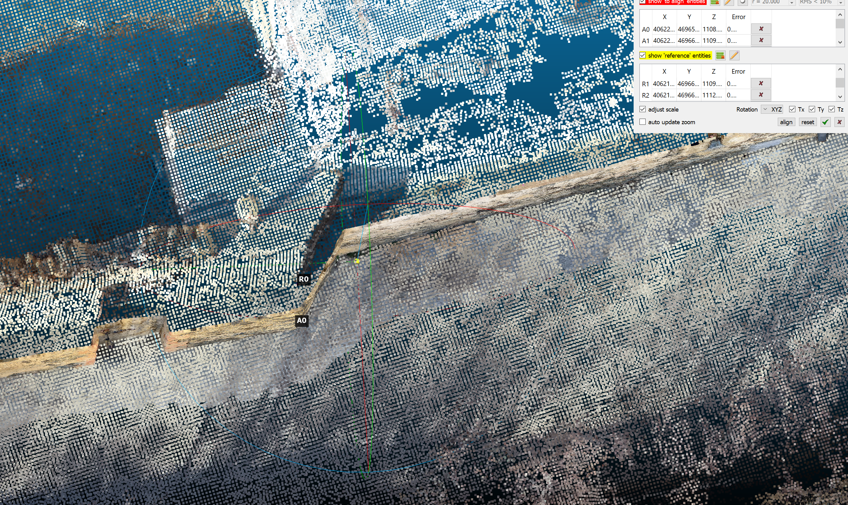

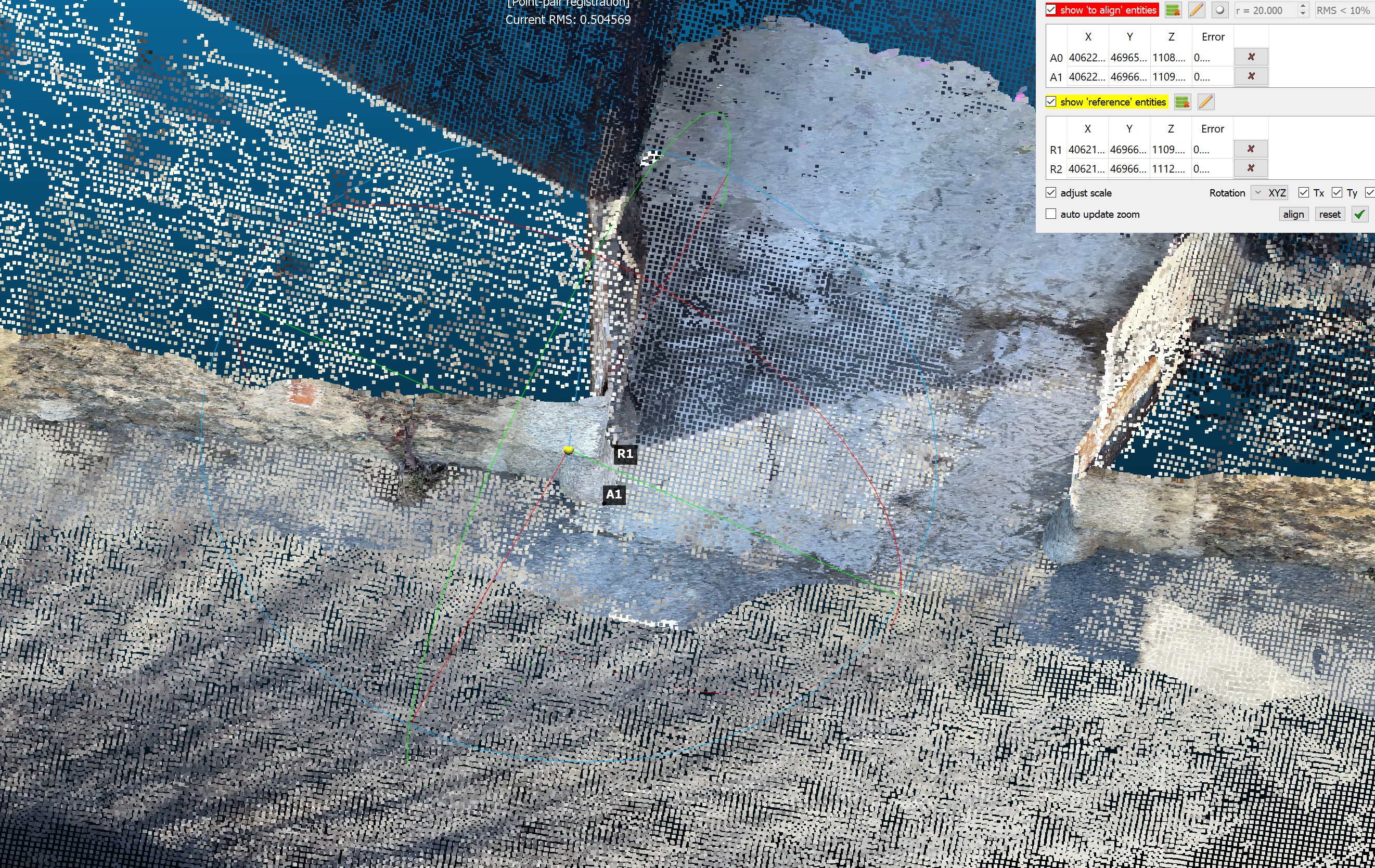

I use the Registration -> Align tool, and it seems it works.... BUT... it doesn't transform the point cloud itself it only tries to put it aligned with the other...
I send A photo so you can see what I mean
Align and transform
Align and transform

I use the align tool until the end. I've clicked on the green check at the end and it transforms the coordinates of the aligned point cloud BUT, it doesn't transform or adapt the point cloud to match the reference points. It doesn't change its relative distances.

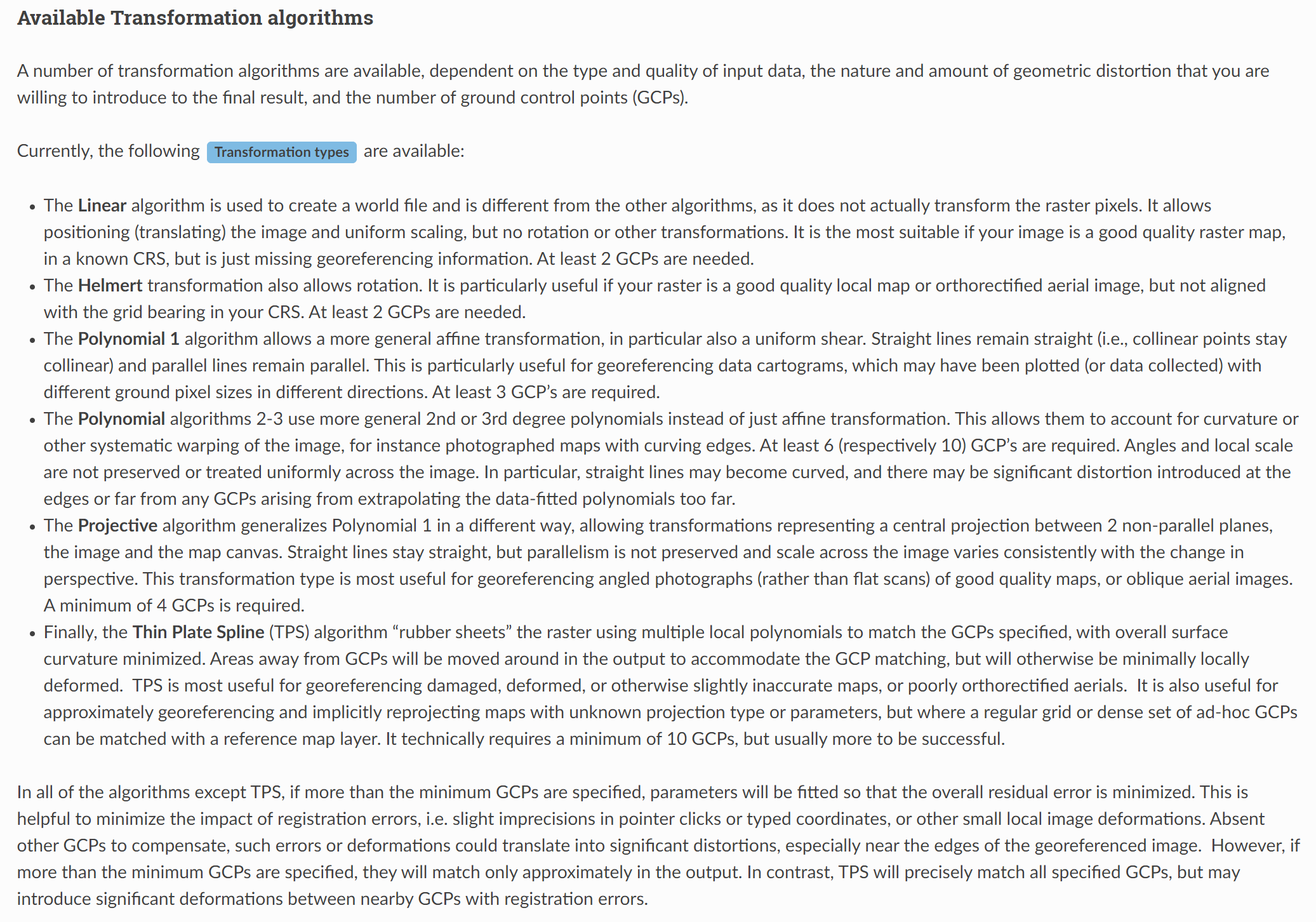

I'm used to use QGIS for GIS data management, and I work with a tool called georeference which from a raster (or a scanned old paper map) you can assign some reference geolocated points and then the aligned raster is transformed, adapted, stretched or shrunk to match the referenced points.
I'm looking for something like that so I can have the correct relative distances like I have in the main point cloud but with the hight resolution point cloud of iphone's lidar for some parts.

These are the transformation types you can use in QGIS if you want to georeference a raster
- transfType.PNG (389.71 KiB) Viewed 6668 times

The best you can achieve is indeed to adapt the scale (with the dedicated checkbox). But CC won't do anything more 'funky' than that ;)
