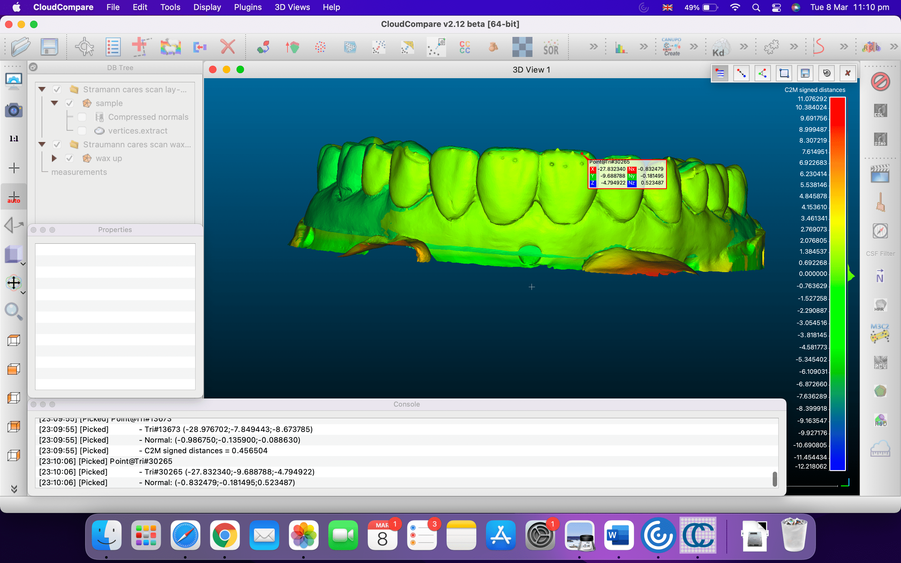

Dear All,
I am superimposing two STL files and I would like to get the distances between these two meshes.
When I used the point picking tool, I managed to get the exact "C2M signed distances" at most of the points I want.
But on certain point, the distance is not showing up, it shows information like "Point@Tri#25792".
May I know what should I do to get measurements show up on these points please?
Thank you very much.
Screenshot 2022-03-08 at 11.10.12 pm-min.png (621.14 KiB) Viewed 1952 times
Screenshot 2022-03-08 at 11.10.01 pm-min.png (639.92 KiB) Viewed 1952 times
Re: Mesh-to-Mesh distance
It's probably because you pick the label on the wrong mesh. You should hide the 'reference' mesh (the one without distances) while picking the labels.
