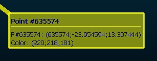

The Point Picking tool display box in Version: 2.5.3 [Windows 64 bits] should show # "point number"(x,y,z) values but instead displays the # "point number"("point number",x,y). The point number is displayed instead of the x value and x value instead of the y value and y instead of the z value.

My bad, you were referring to the simple point picking tool which spawns "2D labels"... I acknowledge the bug ;)

Post by MJS »
Should have added a snapshot to make it clearer!

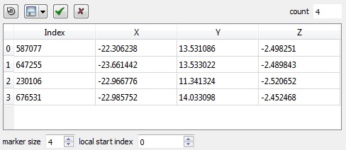

Have you tried with the "point list picking" tool?

Yes, the "point list picking" tool works great. I use both tools, and have different use cases for each. In this particular case, I need to display the vectors that the simple "point picking" tool draws between pairs of points, and also need to get the x, y, and z offsets independently for these points. As a workaround, I exported the points in my cloud to an ASCII file, and then just looked up each point in my vectors from that file by point number.
