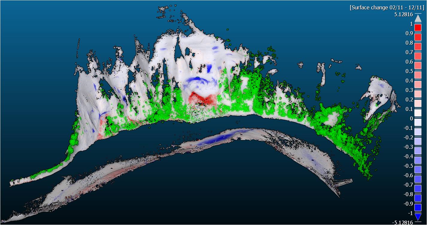

Attached is an example of 3D point cloud comparison of a 500 m reach of a meandering river (the bed is under water) with vegetation classification (in green), and 3D point cloud comparison. The normal is computed at 10 m, and the surface difference done at 20 cm. Core points (where we actually compute the distance) are every 20 cm, while the raw data is down to 1 cm point spacing (and obviously varying accross the scene). I'm sure you'll have recognized your favorite visualization software....I've chosen a scale from -1 to 1 m, but we actually have a registration error between the 2 clouds of about 2.5 mm and can measure really fine surface change.
- Rangitikei river, surface change.jpg (143.66 KiB) Viewed 21087 times
